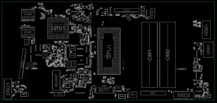

BIOS Inspiron 5501/5508 19775-1
Dell Latitude 3410 - MOCKINGBIRD-L CML - 19709-1 - 19746-1 - 19775-1- 19812-1 Schematic 2

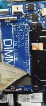

hi, can you help me rebuild these files? i tried with a new 8mb one, it works but can't set the service tag. i tried to do the clearME by myself but i can't find the file with my ME version (13.0.65.2376). with the original file, it doesn't turn on. thanks!
