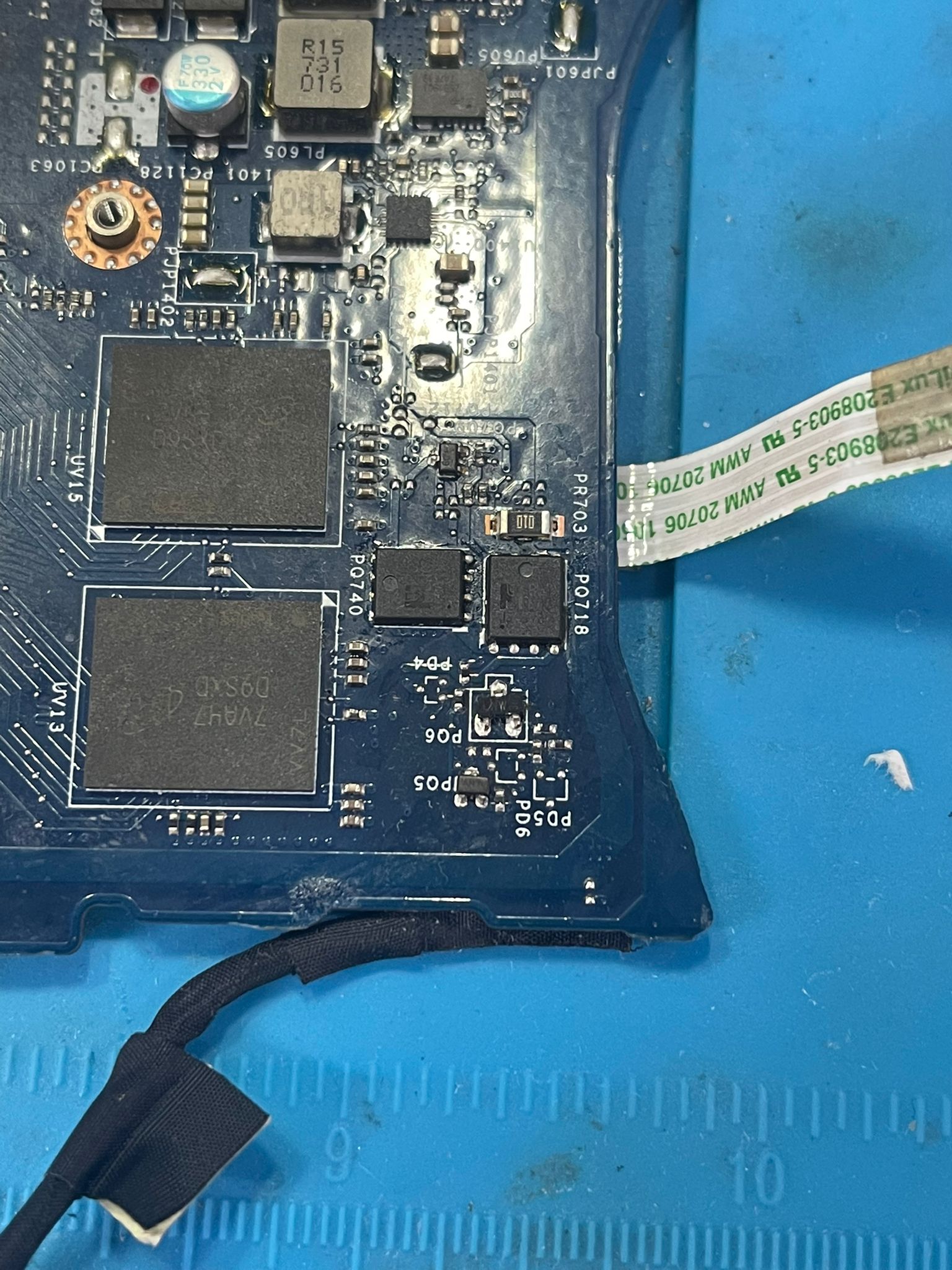

dell la-d801p device works, gives adapter warning, does not see psid, all resistors were measured, pq6 changed, no results, ps id is 1.94v
the problem is not the adapter
tried with the original adapter, it didn't work, and I tried it with 3 adapters from the sub-industry, related to the motherboard
