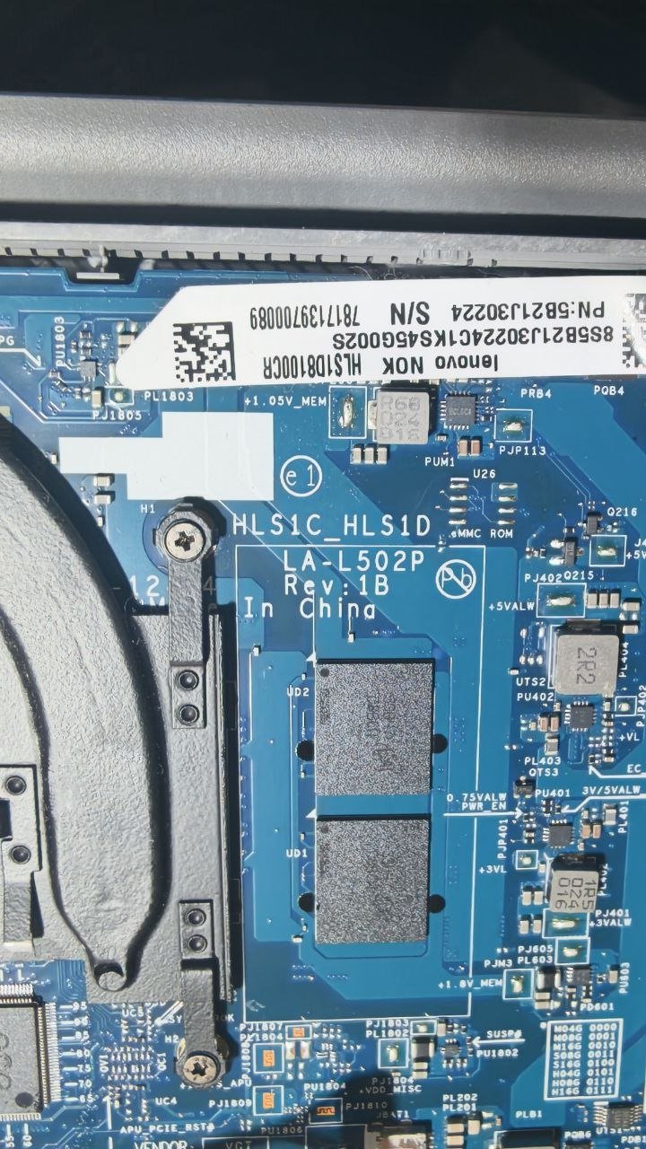

Sir, if this bios is of 32MB and this is of 16MB then how did the display come on the 32MB one??
not amd chip problem sir
Normally you just need to program the BIOS 16MB file on IC 128 then back it up and you will have BIOS 32 but only 16MB of data.
