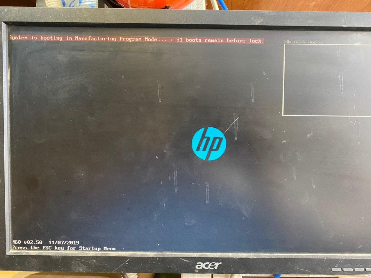

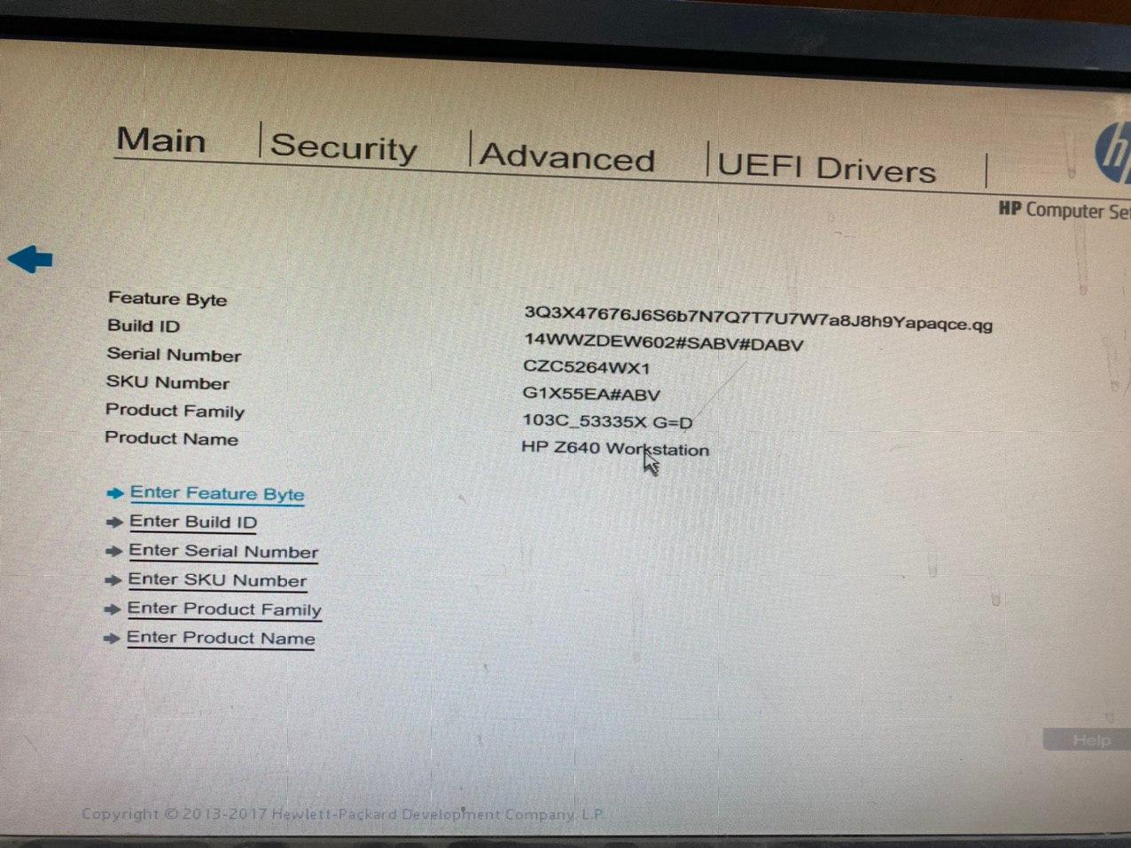

Your no display file information post #18
MODEL: HP Z640 Workstation
SERIAL:
MAC: EC:B1:D7:3E:4D:FB
SKU: G1X55EA#ABV
FD: V1
NVAR ID: 3F
BUILD ID: 14WWZDEW602#SABV#DABV
BOARD CT:
FEATURE BYTE: 3Q3X47676J6S6b7N7Q7T7U7W7a8J8h9Yapaqce.qg
UUID:
COA: Q8HN3-QH34Q-XBDMC-Y9VVD-RJP7P
ME: 9.1.25.1005
