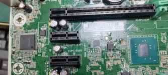

BID N51 Version: 01.27
0101aqh08-491-h
ATAYAL REV 1.00
N51_0174.BIN
I dont understand why both files are 8Mb, but this is the other BIOS chip reading.
if I use your bios files, I get 3 beeps and flashing red and white on power button.
name chip 128=16MB
but you backup 8MB
that shows you don't know how to backup BIOS
