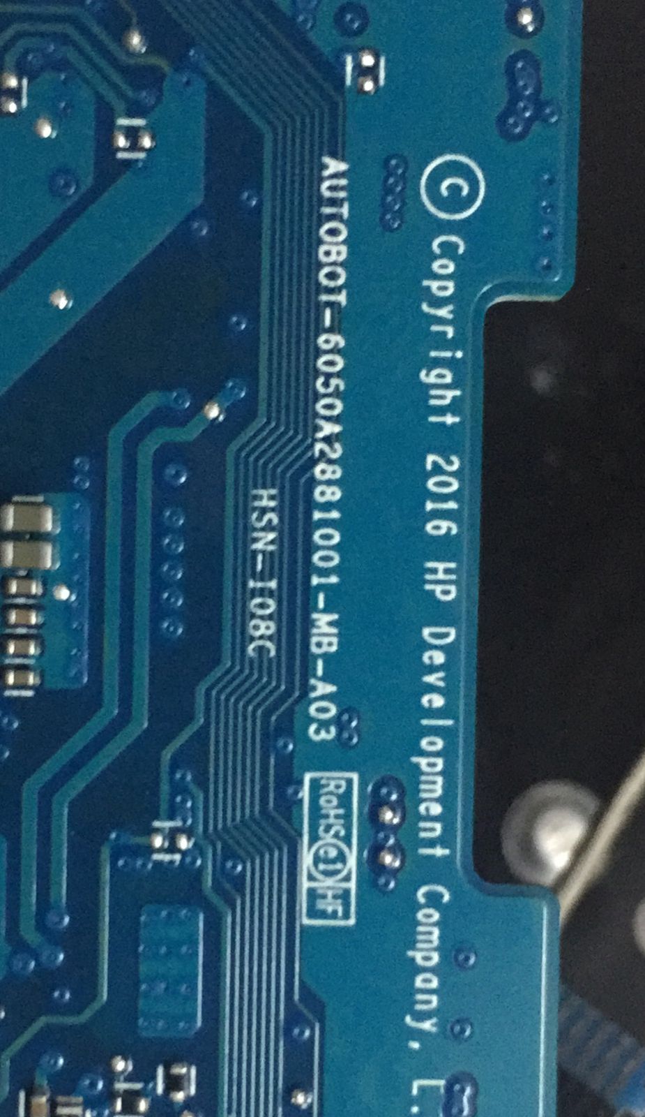

HP x360 1g11 autobot-6050A2881001-MB-A03
skip dmi after that laptop work normal ?dear i try to read IT but some problum in programmar i want aske u some,when i put very first page second me clear file password gone but serial number error show so plz do some if possible
yes everything work perfectskip dmi after that laptop work normal ?
When I try to use windmifit in windows I get the below errortry bios this
or need use tool add dmi
Series Number HP (HP DMI) NBDmiFit and WNDMIFIT
Collection Series Number Notebook HP (HP DMI) NbDmiFit, DMIFIT HP provides the following tools for re-flashing the DMI region: HP Mobile Firmware Interface Tool (DMIFIT) — this tool, introduced in 2009, combines the previous consumer and commercial notebook DMI flashing tools (HPSetCfg and...vinafix.com
Manufacturing mode is not in unlock state
not sure BIOS, you need try BIOS other and comparein my case laptop charing batery but not power on, i flash other bios but stil not power on
KBC name ?anyone have KBC (ite) firmware i need to try it
ITE IT8987E
form Original or new bios ?Have anyone maybe solve problem with serial numbers?
i write dump from vinafix,clear me,work laptop is unlock,but i cant write serial,that is problemform Original or new bios ?
BIOS Original where ? you have save it ?i write dump from vinafix,clear me,work laptop is unlock,but i cant write serial,that is problem
yes i have lock original bios,here is in attachBIOS Original where ? you have save it ?
