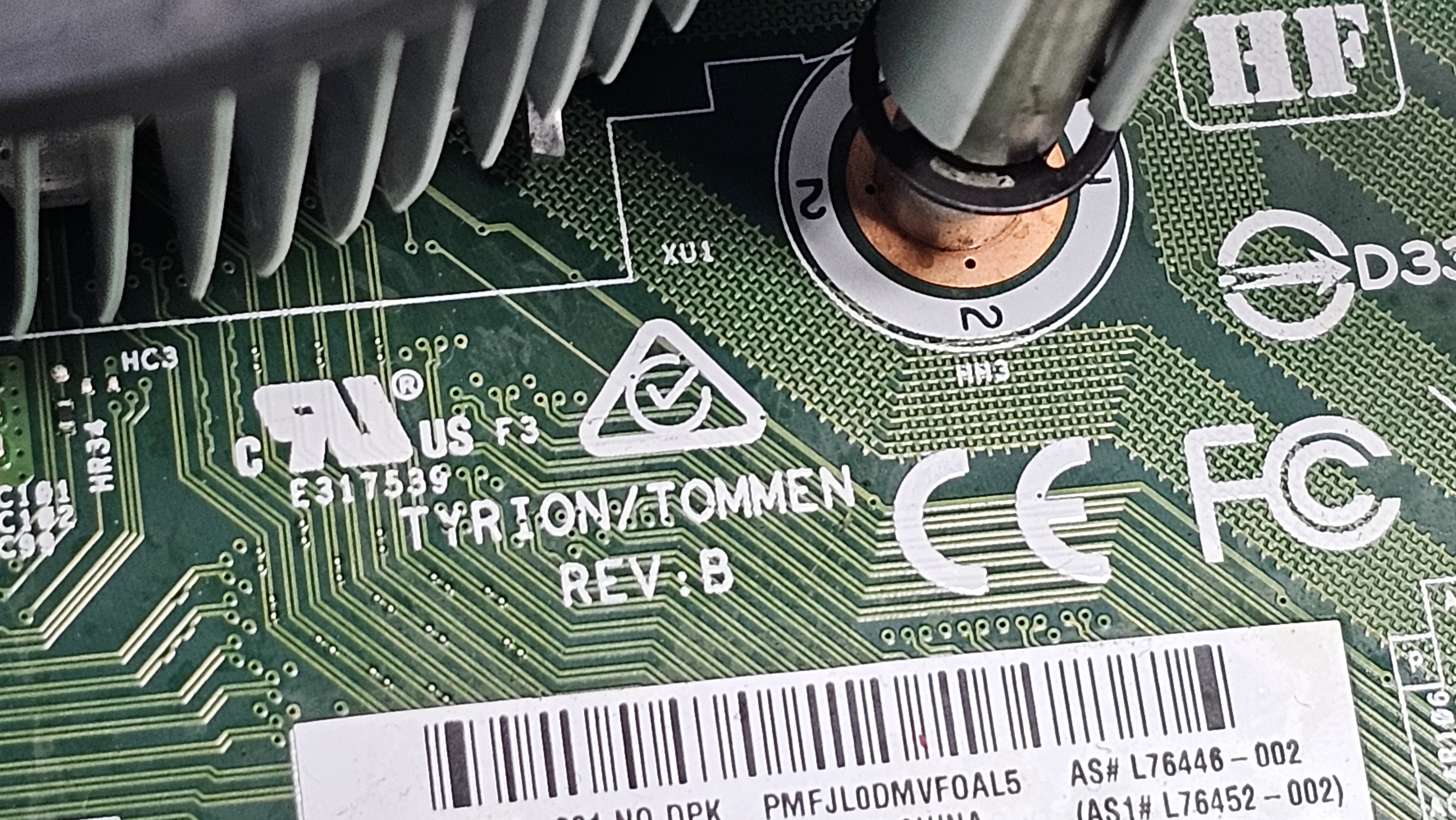

Please rebuild this bios
pc start for 3 seconds then shut offView attachment 367916

This one not working.HP ProDesk 600 G6 Small Form Factor PC BIOS S07

I already tried to zero out UserCred variable at 0x18241cc (4544 bytes) but it's not working so i did some research and found out that the second 16Mb chip has a 32b passwrd hash on it at 0x1300, zero out that one, flash both chips again but still no change.
Are you sure you can do it?
