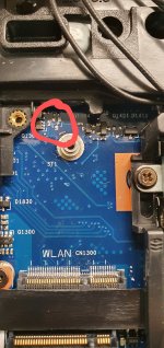

I have 6050A2930001-MB-A01 motherboard with missing component. If anybody have this motherboard on hand, can you upload HQ photo with this area? This area can be accessed without disassembling laptop, only need to remove bottom cover. I would be very grateful :)
It`s the same component like the next to em. q1303 and q1301 are same.
