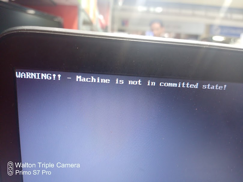

please rebuild the bios, the old bios starts the motherboard but turns off after a while, no video. capslock 1 will blink
HP probook 450 g3
MB: DA0X63MB6H1 rev:H
graphics card : AMD 216-0864032
OLD.bin
problem solf okay but warning
HP after clearme is always like this
you can try tool this
or use BIOS no clearme
