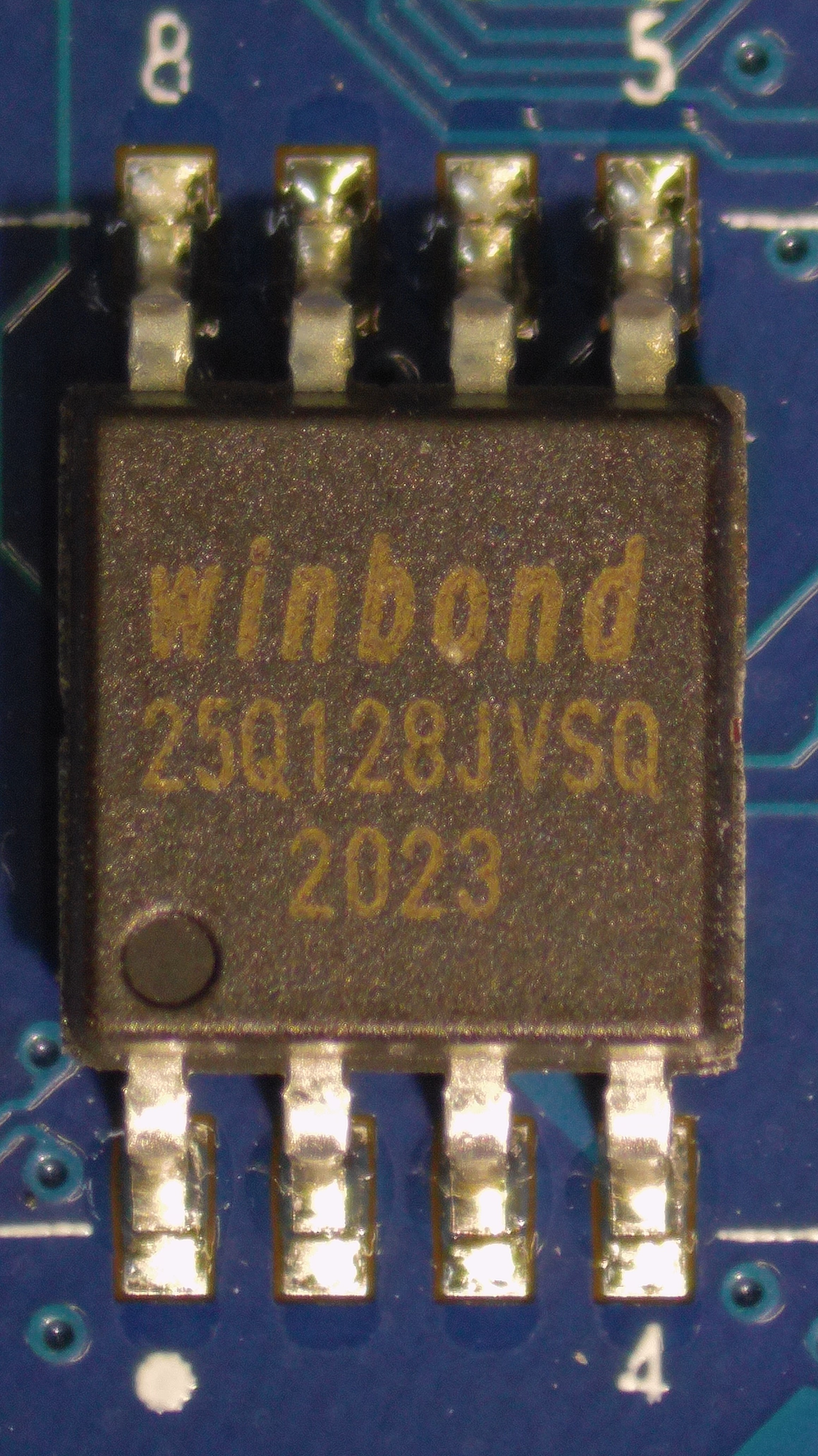

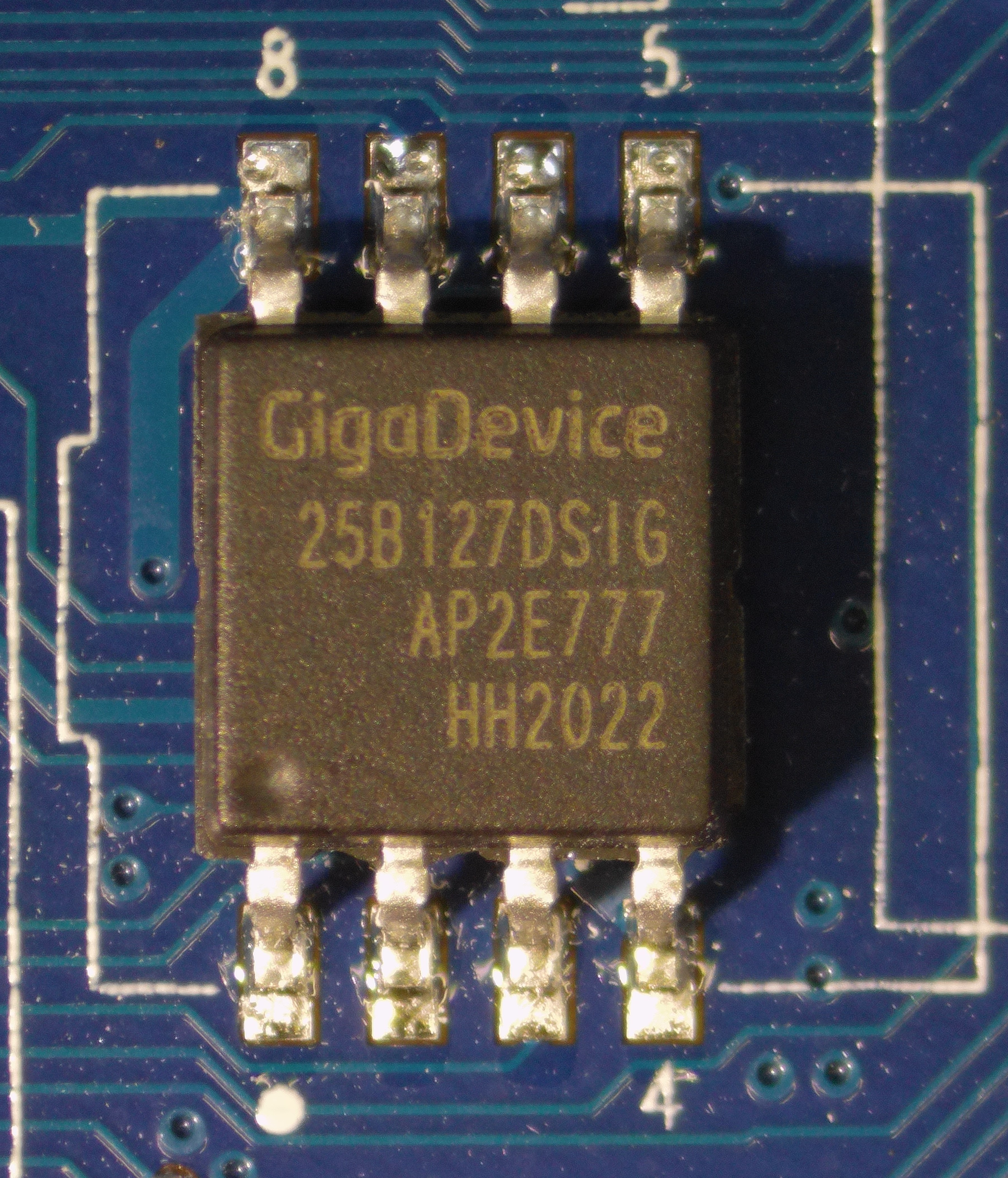

I have hp 450 g7 with corrupt bios but it has two chips the first one is 128 and second is 128 two so how can I programme both bios?

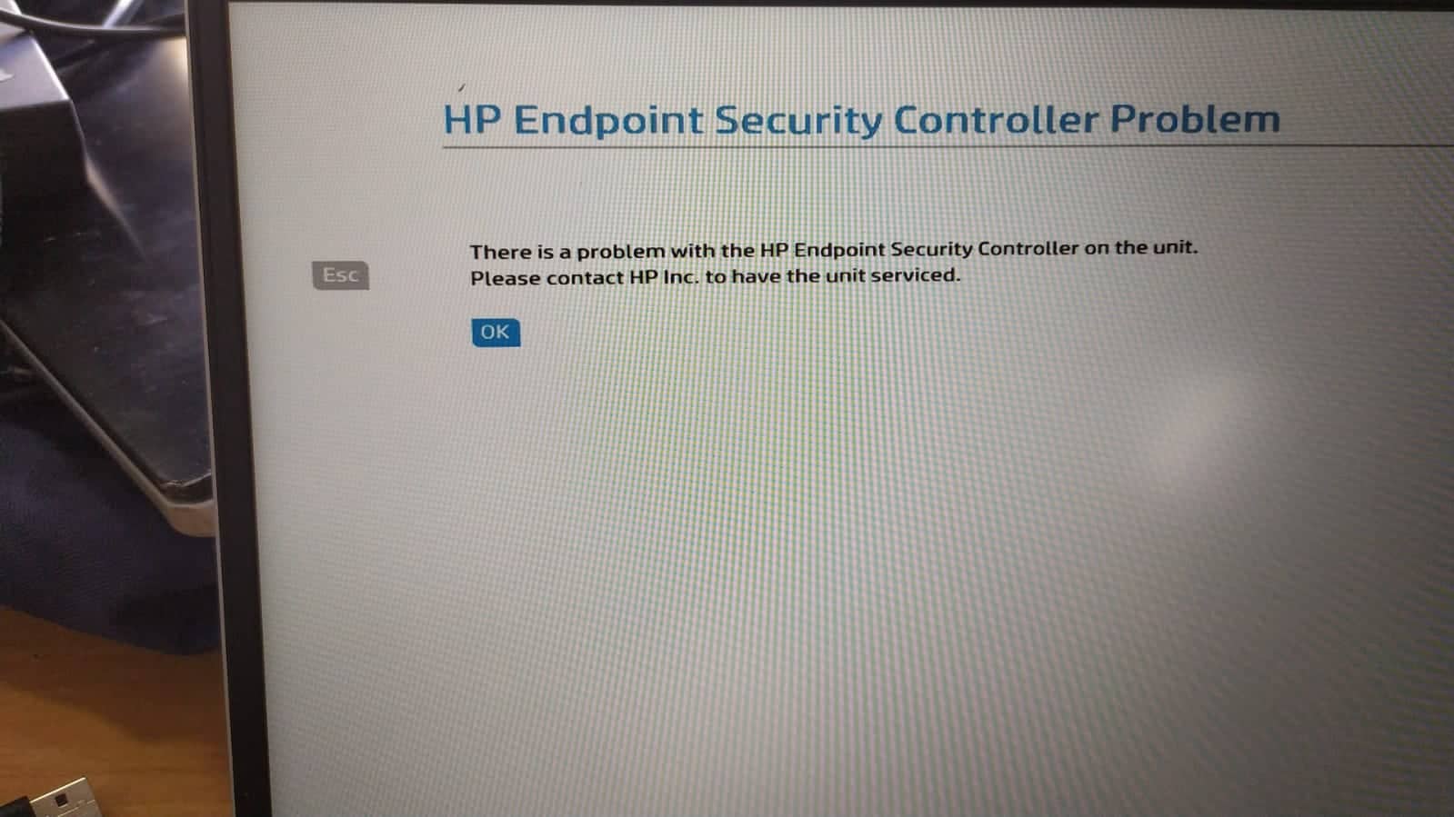

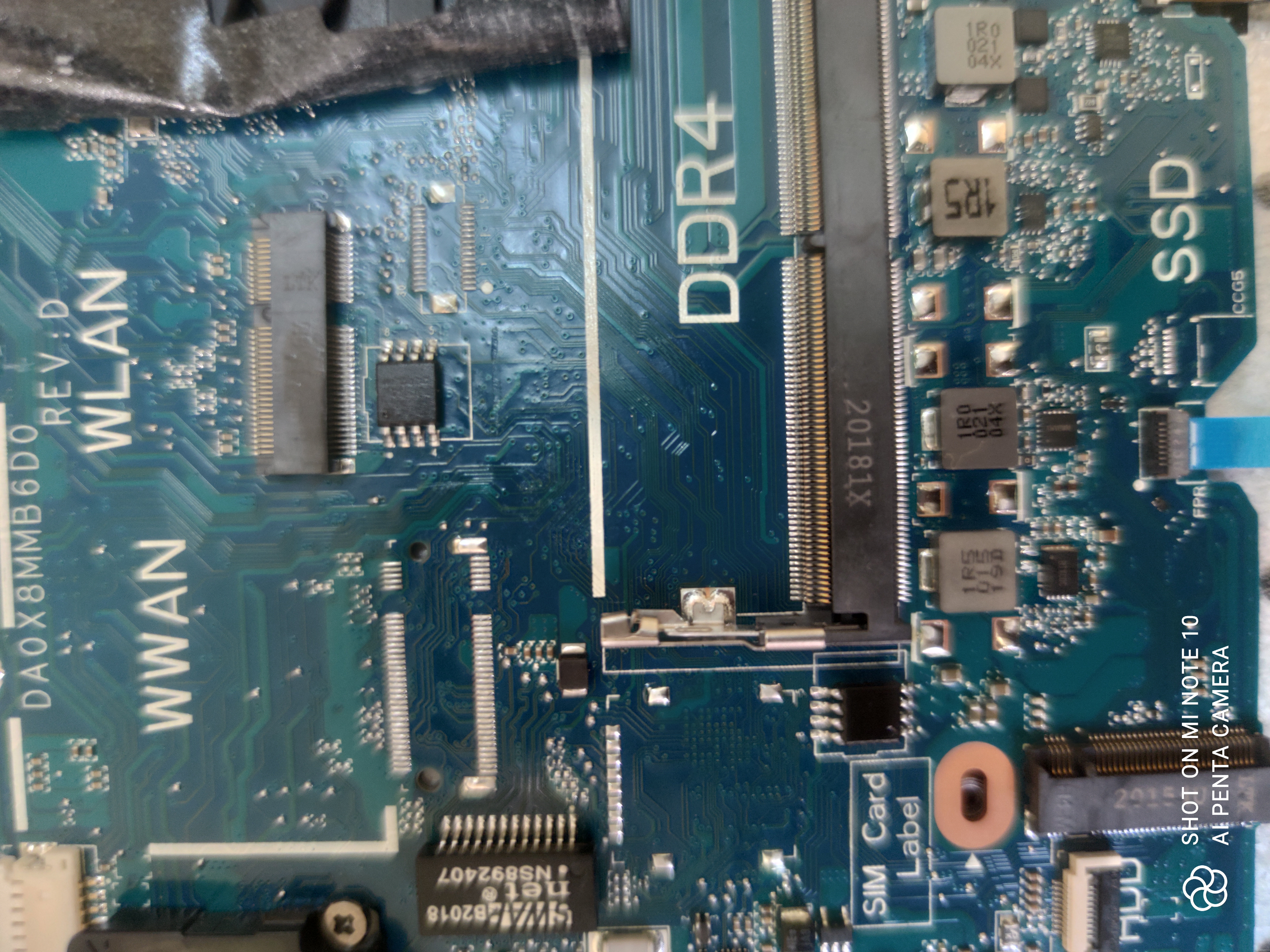

Hello, i have the same Laptop (HP ProBook 440 G7) (DA0X8MMB6D0)
every time i start the PC this massage appear (HP Endpoint Security Controller Problem)
i attached a pic for the problem.
can it solve by reprogramming Bios?

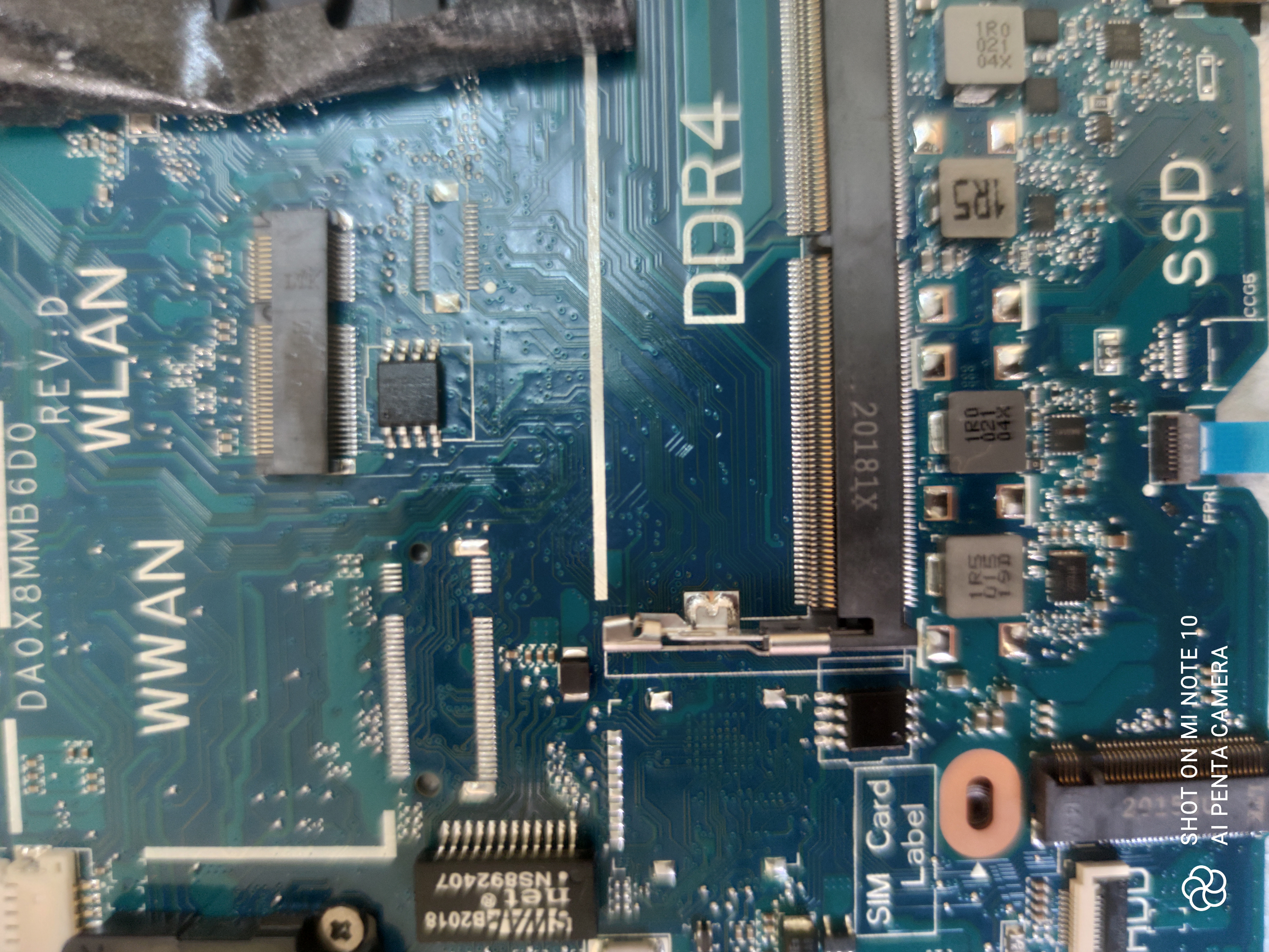

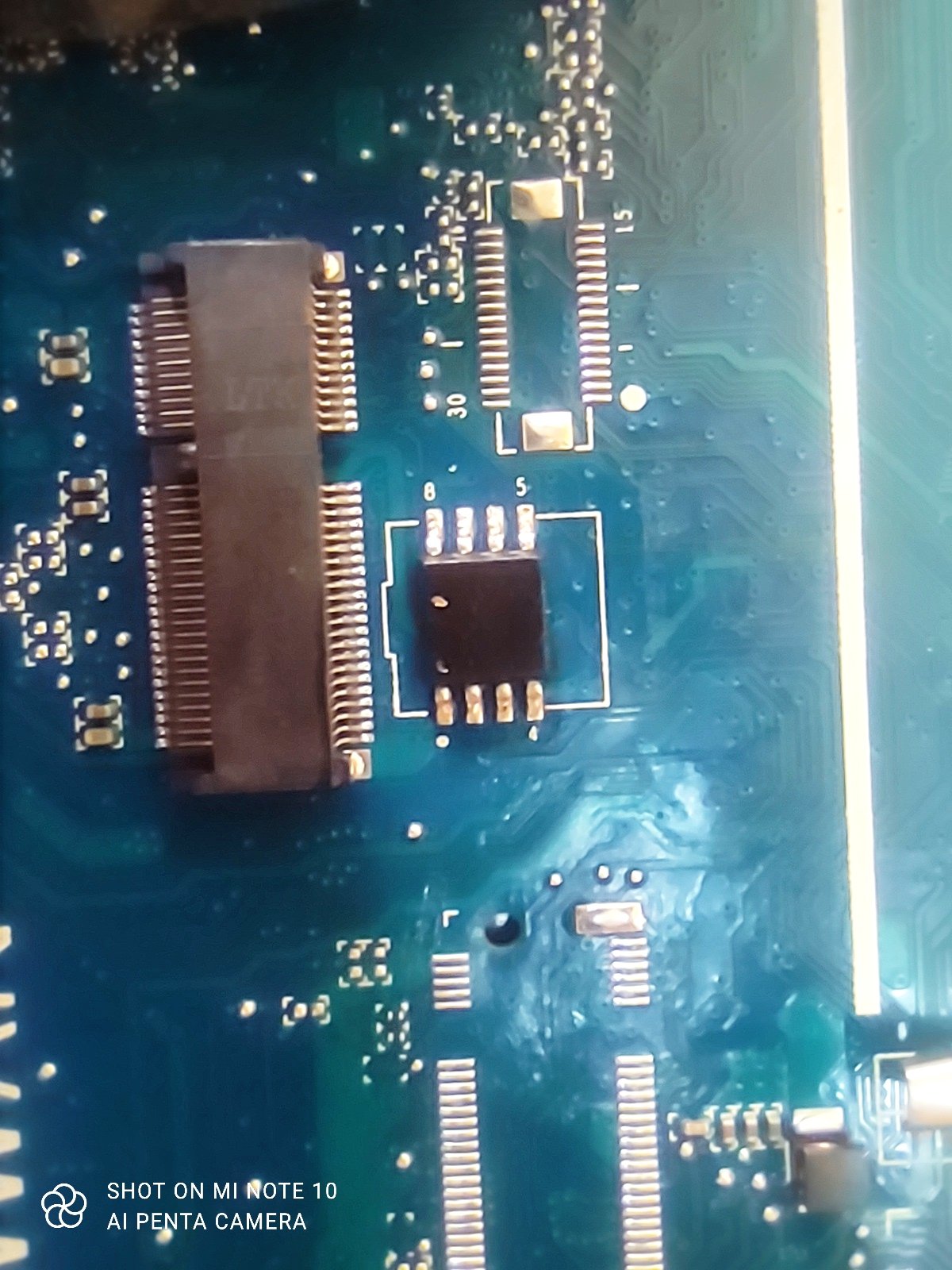

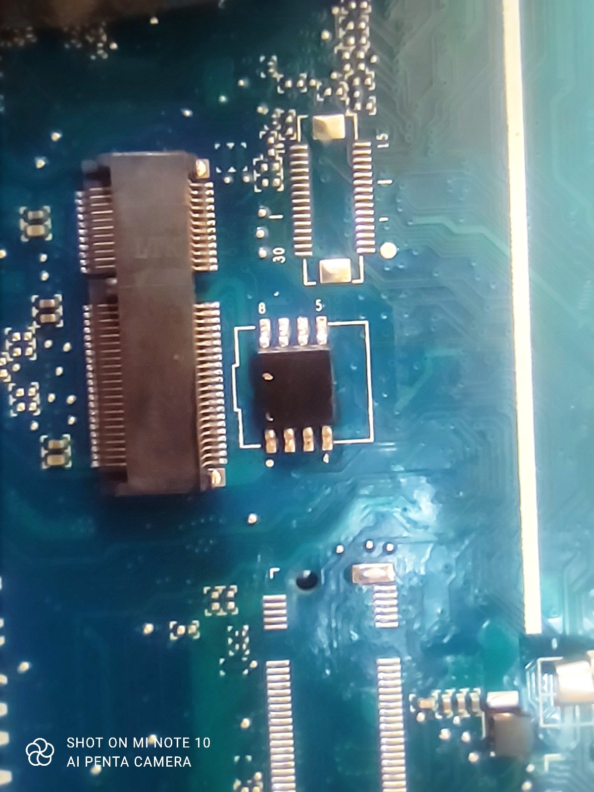

i have tow Bios IC in that Motherboard
Just return the original 16MB BIOS
there is tow Bios IC on the motherboard,
I Don't know which one of them is EC or main
both of them are 16MB
i attached the backup for the both IC's with the number of each IC
I not request BIOS
If you program the BIOS, you must accept this error
With G6 G7 unlocked, you need to buy a patch if you don't want this error.
