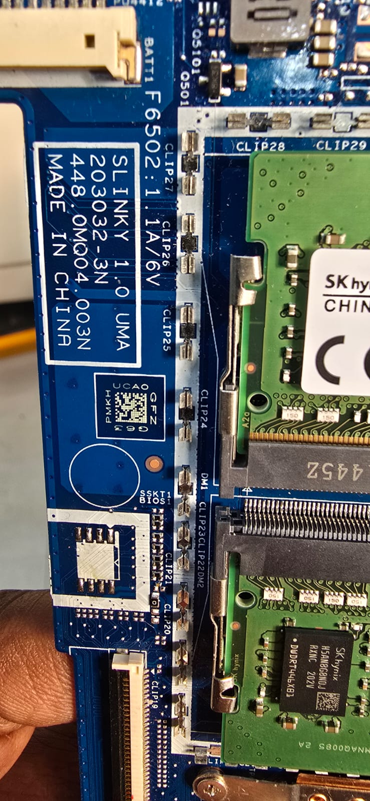

BIOS HP Pavilion x360 14 Convertible PC 14-dy0000 (45W97AV) 203032-2
203032-2 BIOS
SLINKY 1.0 UMA_MB_8L
0AB88.bin
0BB88.bin
0CB88.bin
088BA.bin
088BB.bin
088BC.bin
HP SLINKY DY13 X360 203032-4 0AB88
Wistron SLINKY 203032-1.pdf
Wistron_SLINKY_UMA_MB_8L_203032-2.cad
Wistron SLINKY 203032 -2
KB_pins=40 LEFT DOWN 08MM FLASH=256 JENK=7 TCK=11 TMS=13 TDI=18 TDO=10 CHIP=NPCE38APB1BX

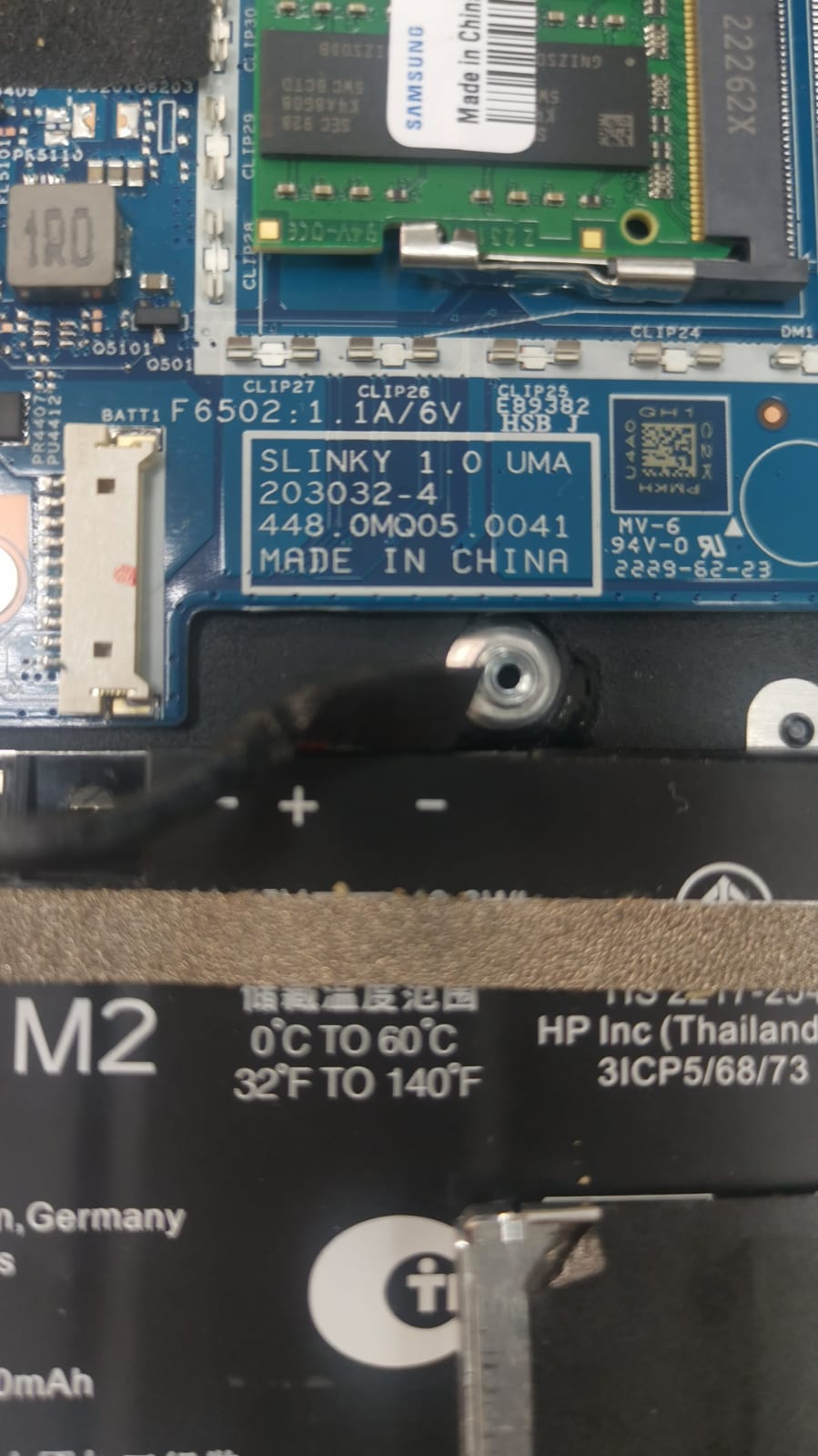

203032-2 BIOS
0AB88.bin
0BB88.bin
0CB88.bin
088BA.bin
088BB.bin
088BC.bin

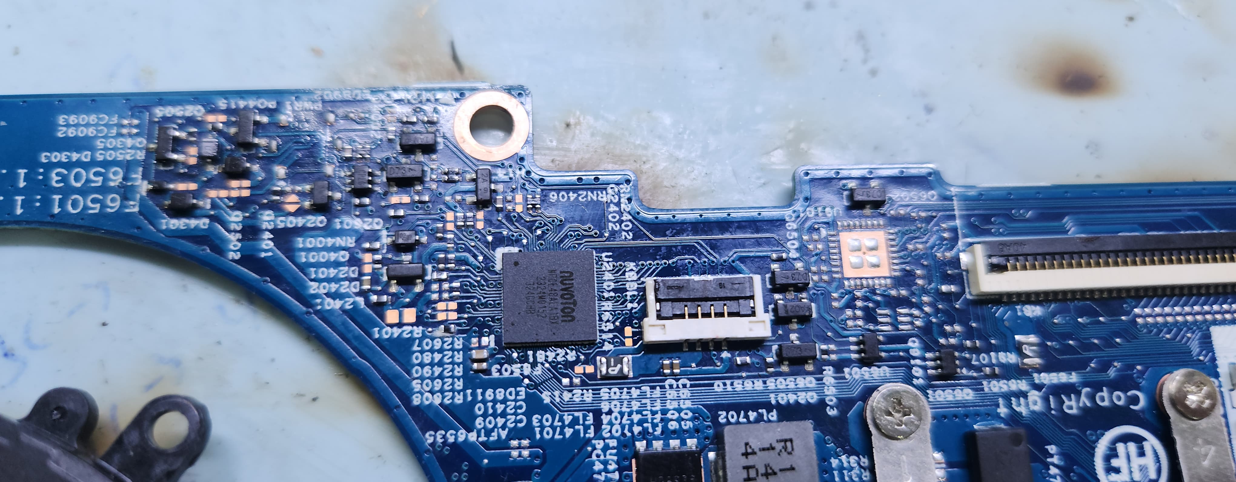

this is programable controler
