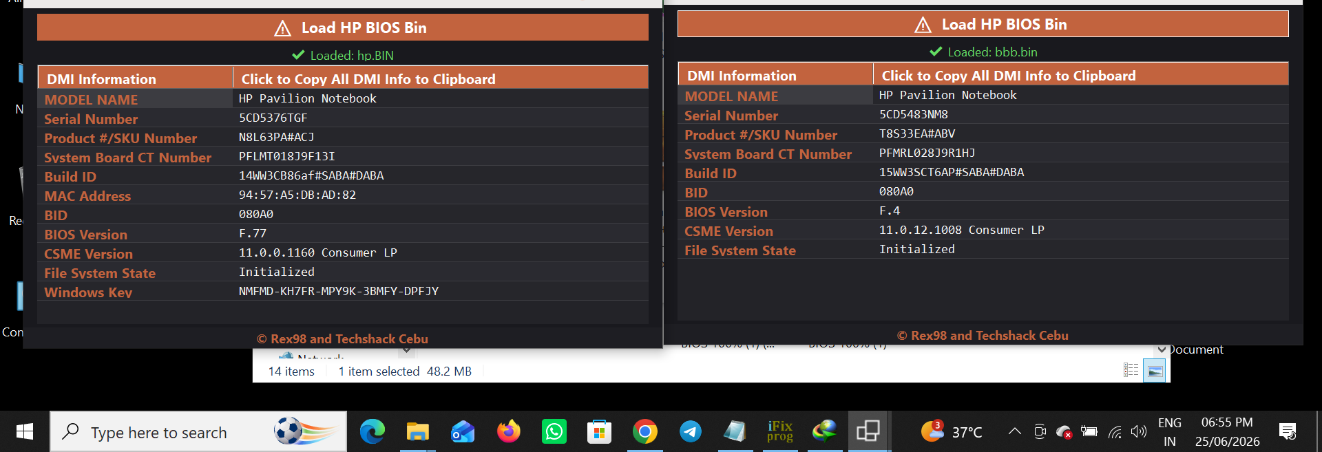

I made a mistake trying to replace the HP logo and now I no longer have a working BIOS.
Running picture I have 80A4! and not 80A0
The first BIOS works halfway - but the device is very slow and only starts reluctantly.

I tried to replace the HP logo with the Insyde tools - but since I didn't know which attributes (jpg bmp - resolution etc.) I advised that and I think that the Insyde tool destroyed the image. Unfortunately!!! I don't have any backup anymore... just a bunch of non-functioning bios files. The main bios starts but it's very difficult and unfortunately not always. The battery is not recognized - The device sometimes starts despite Caps Locks 5x long 3x short (screen is on and just before the last flash the HP logo appears and Windows starts)
!!!!!The attached file is now the BIOS that is on the chip - but! As I said, it's difficult to run!!!!
**edit - The picture is from the bios when it was still working! Before... I tried to swap the HP logo**

not Understand, I think you need try one bios new
