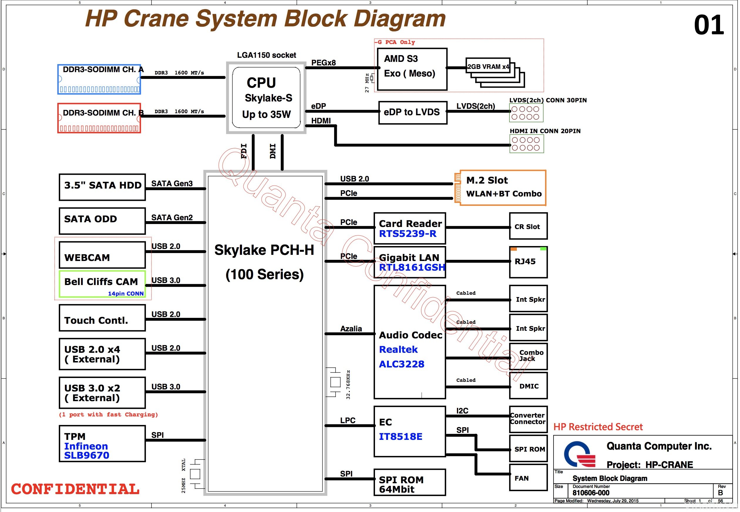

HP Crane System Block Diagram

sir ihave hp pavilion all in one 27-n101a . board id DAN61AMB6F0 REV F power button led blinking 7 time not turning on need hellp
any idea whats mean power LED blinking 7 time in this model i face many time this problem
Model hp pavilion all in one 27-n101a borad id dan61amb6f0 rev f
