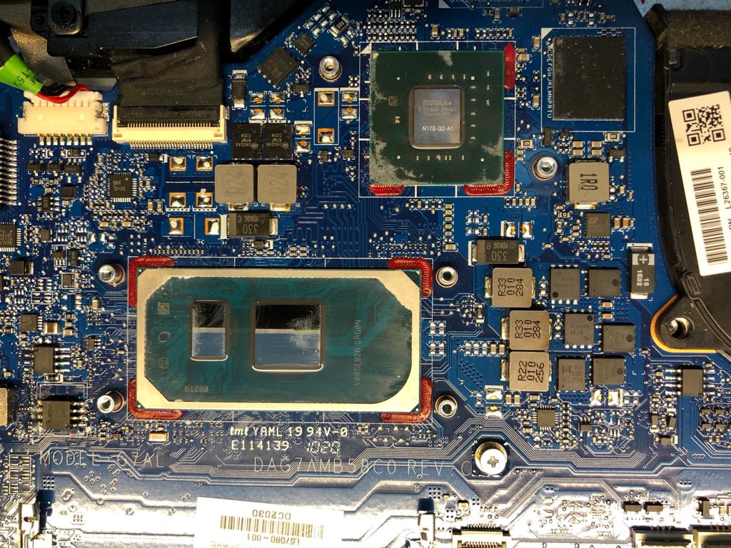

HP PAVILION14 QUANTA G7AL photo
Quanta G7AL KB_pins=32 LEFT DOWN 1MM PD0=26 PD1=22 PD2=20 PD3=15 PD4=19 PD5=23 PD6=16 PD7=18 BUSY=29 STB=21 AFD=32 INIT=25 SLIN=24 KSI4=28 KSI5=27 CHIP=IT5570E-128

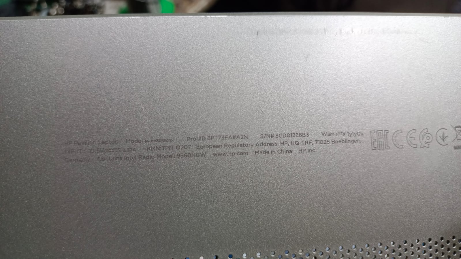

hi sir.
hp 14-ce3007ne have no display. I flashed 2 bios from 1st page but no display.
s/n 5CD0110M4T
