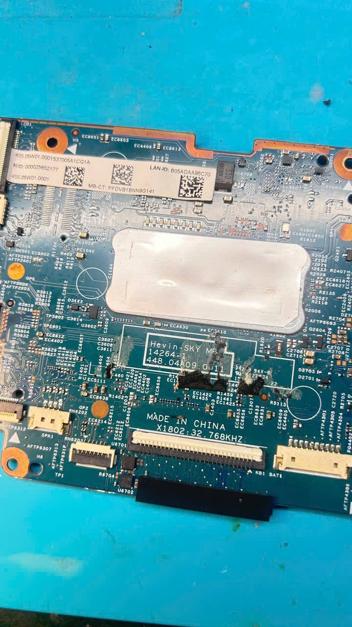

Any idea what dmitool works with this model? I've programmed 08075 ok. Machine boots with manufacture mode message. Tried using version 2.07 through 2.13 of the NbDmiFit. But none recognize this model.
You need test and find version fit, or send old bios error and provided motherboard code i can help fix by hand.
