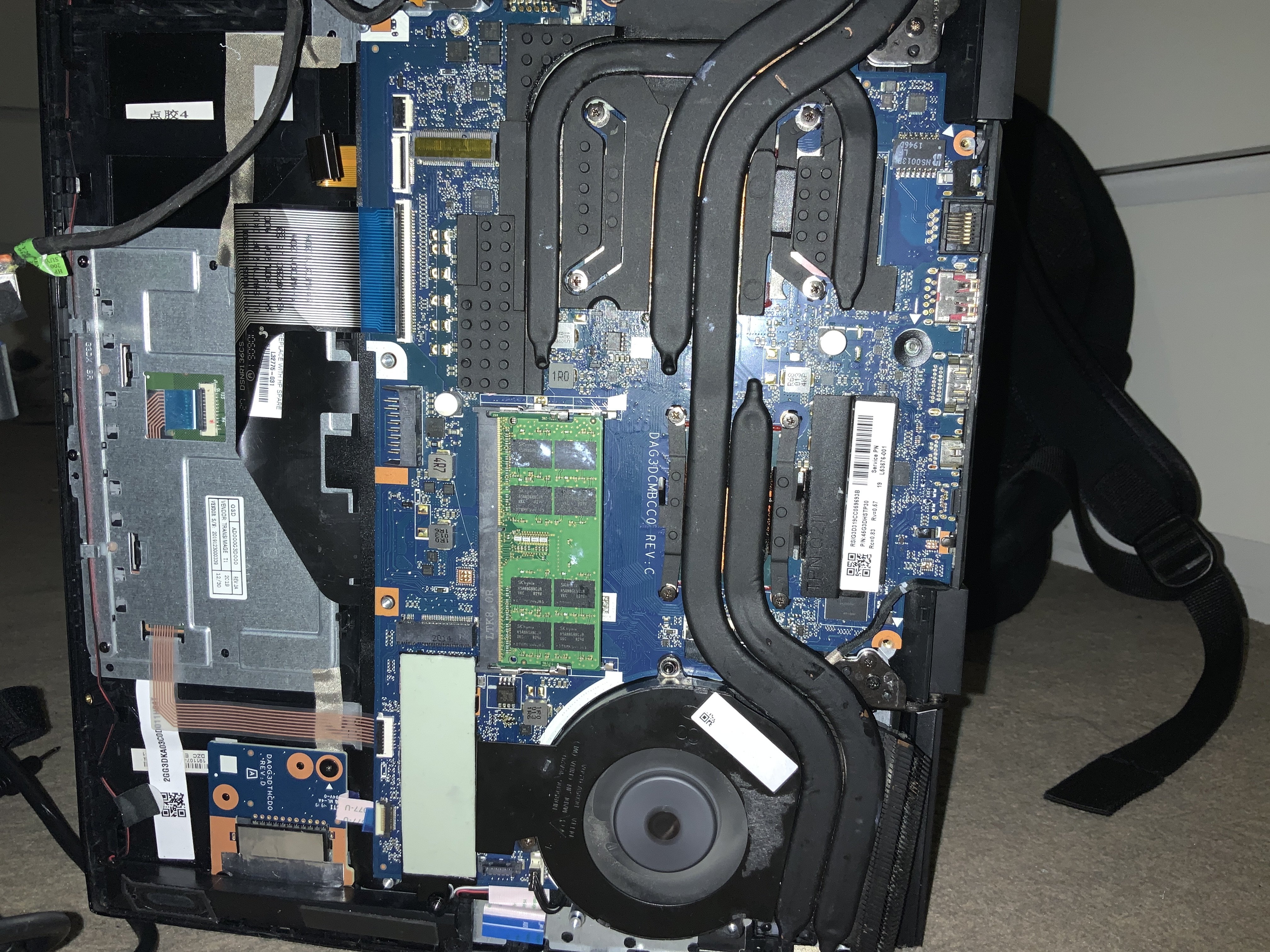

Hi! I hope you can help me
i have a HP OMEN 15 DAG3DCMBCC0 Rev: C and I have no display. It power on the keyboard is lightning but no display at all. Not even HDMI. I hope someone can help me with a solution. I’m new in repairs and I don know from where to start. I checked the RAM voltage and is 1.3V. That’s ok
hi, have a dc1007nu - already tried to flash some ROMs, but no screen, just once it told me, system bios will be cleared, do not turn off, this was 100% for 30 Mins, nothing happens...
maybe you can fix the originals (if customer did not already try himself they are originals)
Omen.zip
reflashed the 1MB ROM with correct data - seen customer already flashed some shit on it, and now it boots up without an issue
