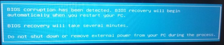

please help i need schematic or board view,, i need to check nvme slot, it is not detecting the nvme storage.
There is no diagram but note that nvme only works with the original bios of that laptop. If you have programmed another BIOS, nvme will not detect it.
I have tried other bios from your forum. This is the original bios has this error with loop. other bios has no displayand consuming flactuating with higher current. please help
ready Programming one bios new ??
