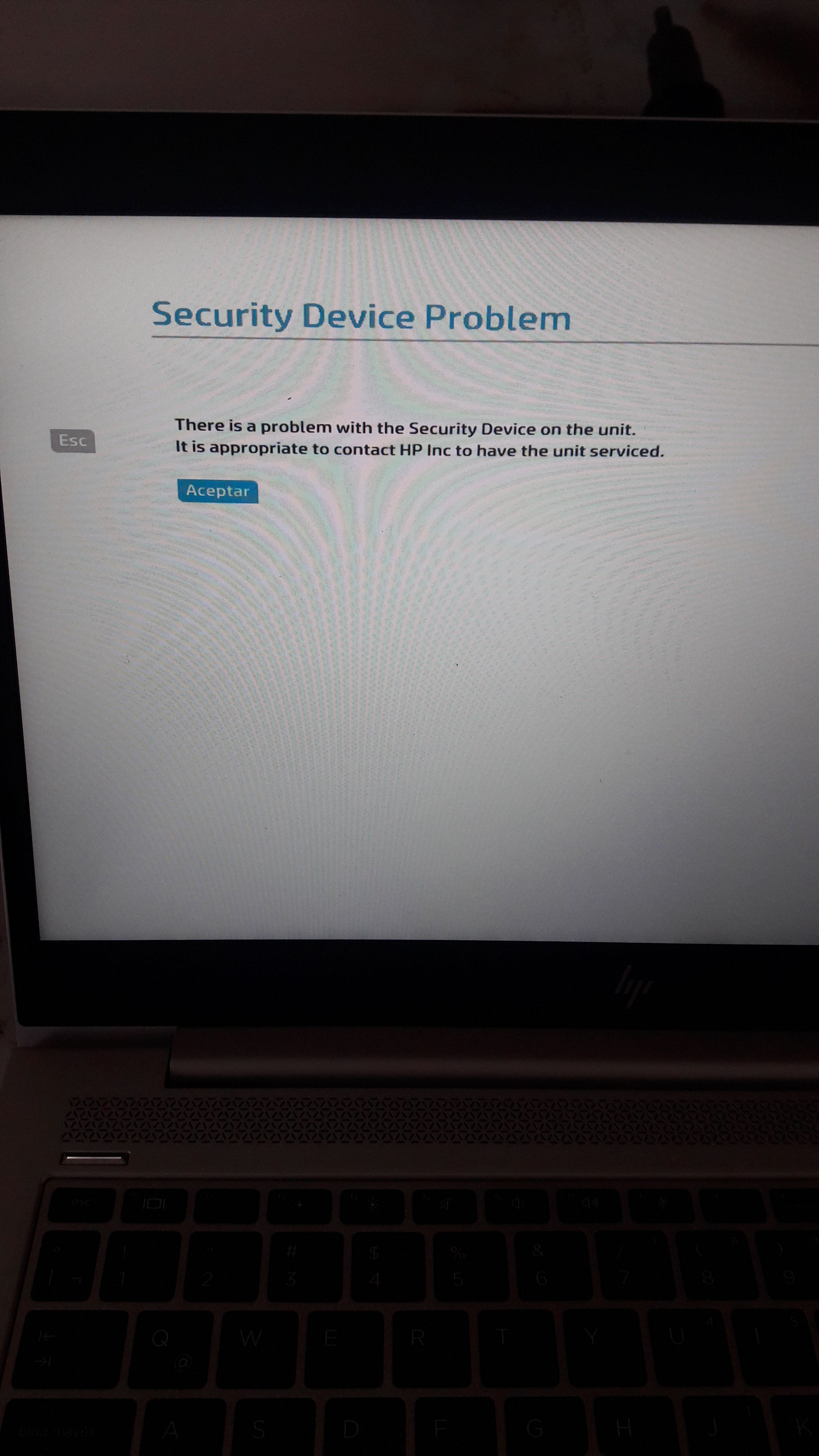

I program 128 whith w25q128fv and works , but show this menssage, i need program 25q256?
