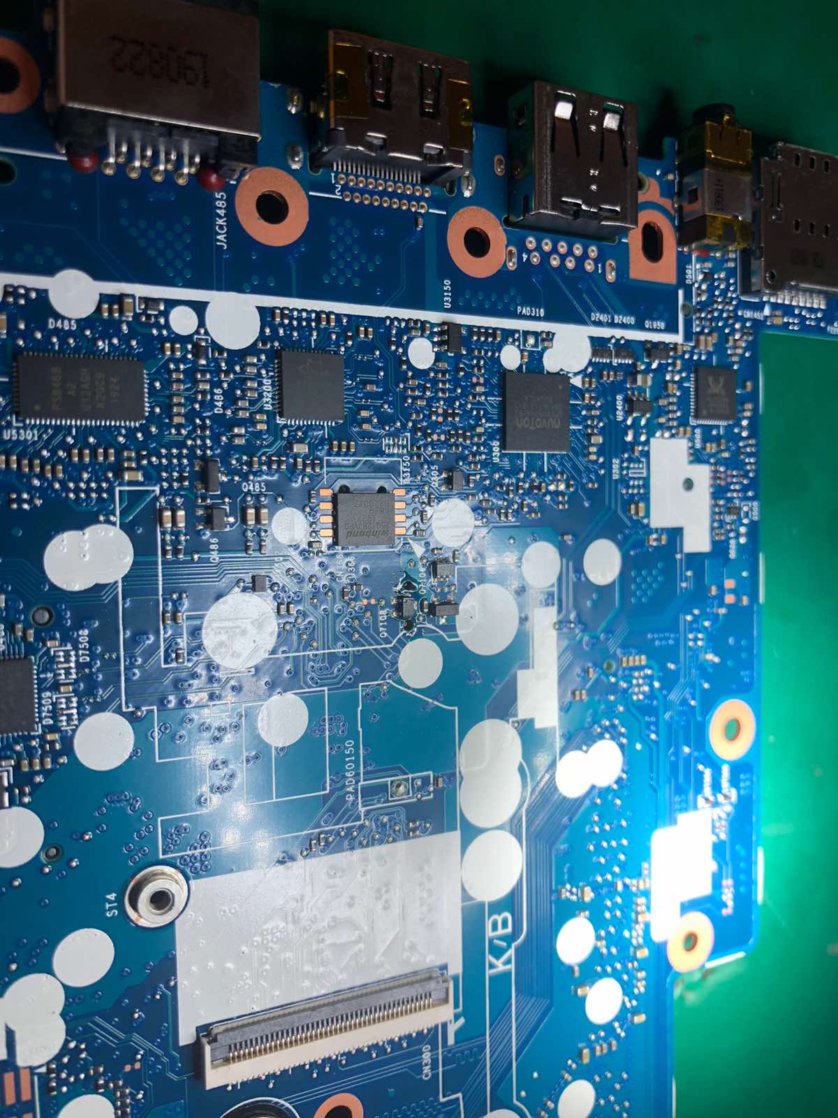

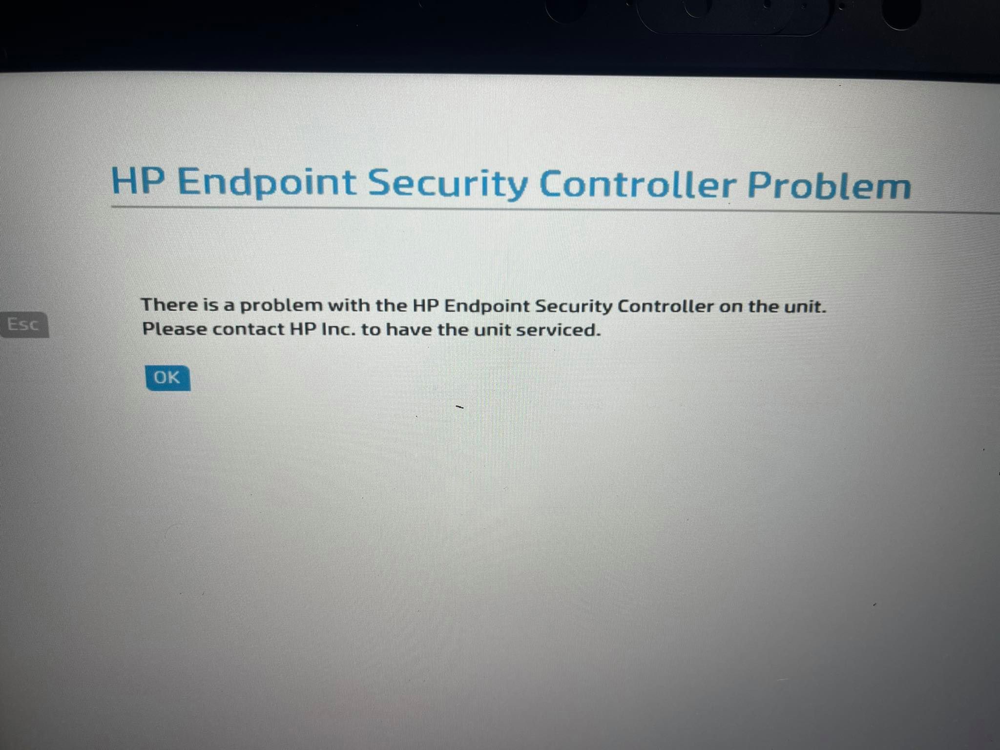

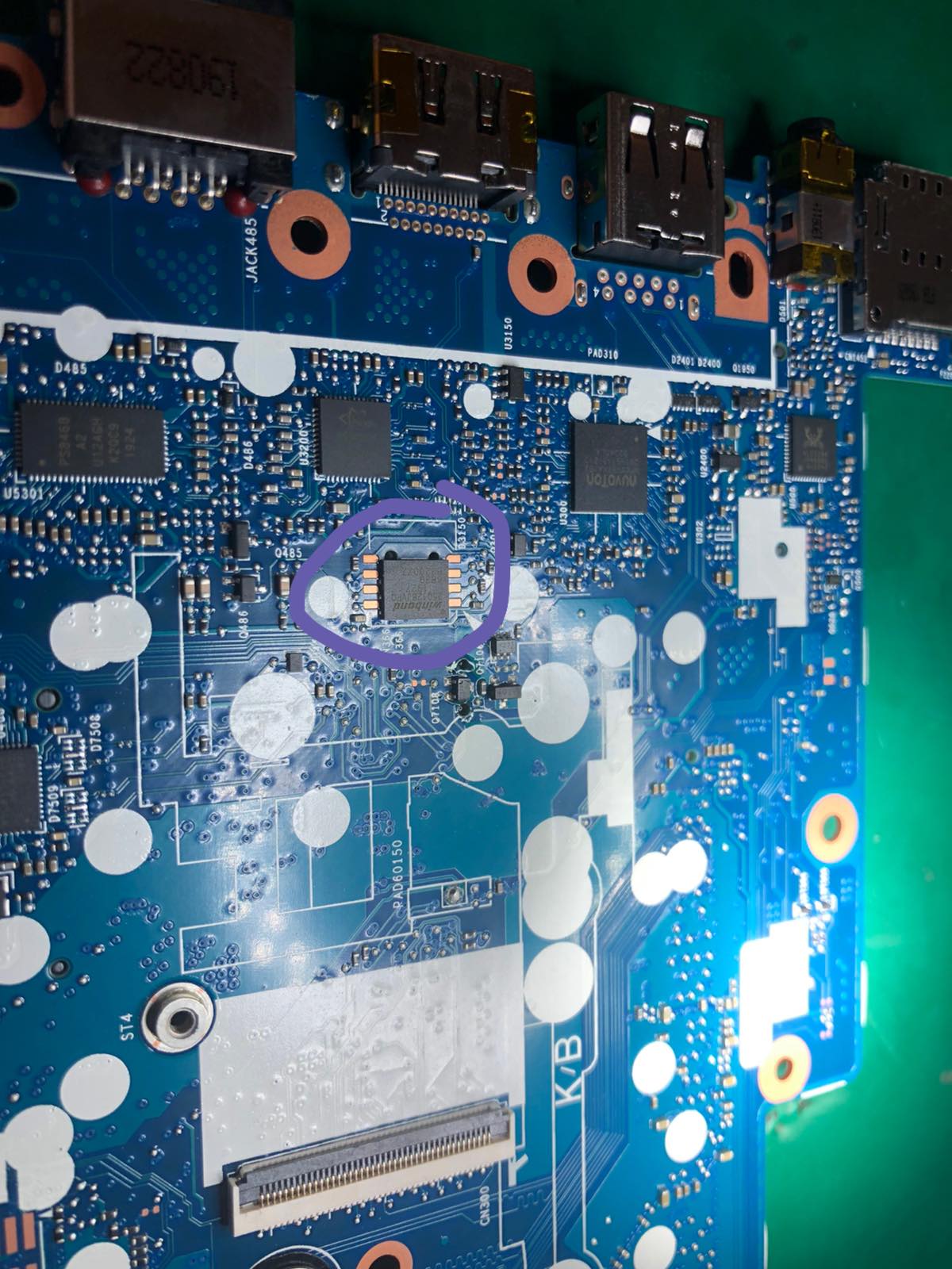

send i one photo display, and i think There is one more bios

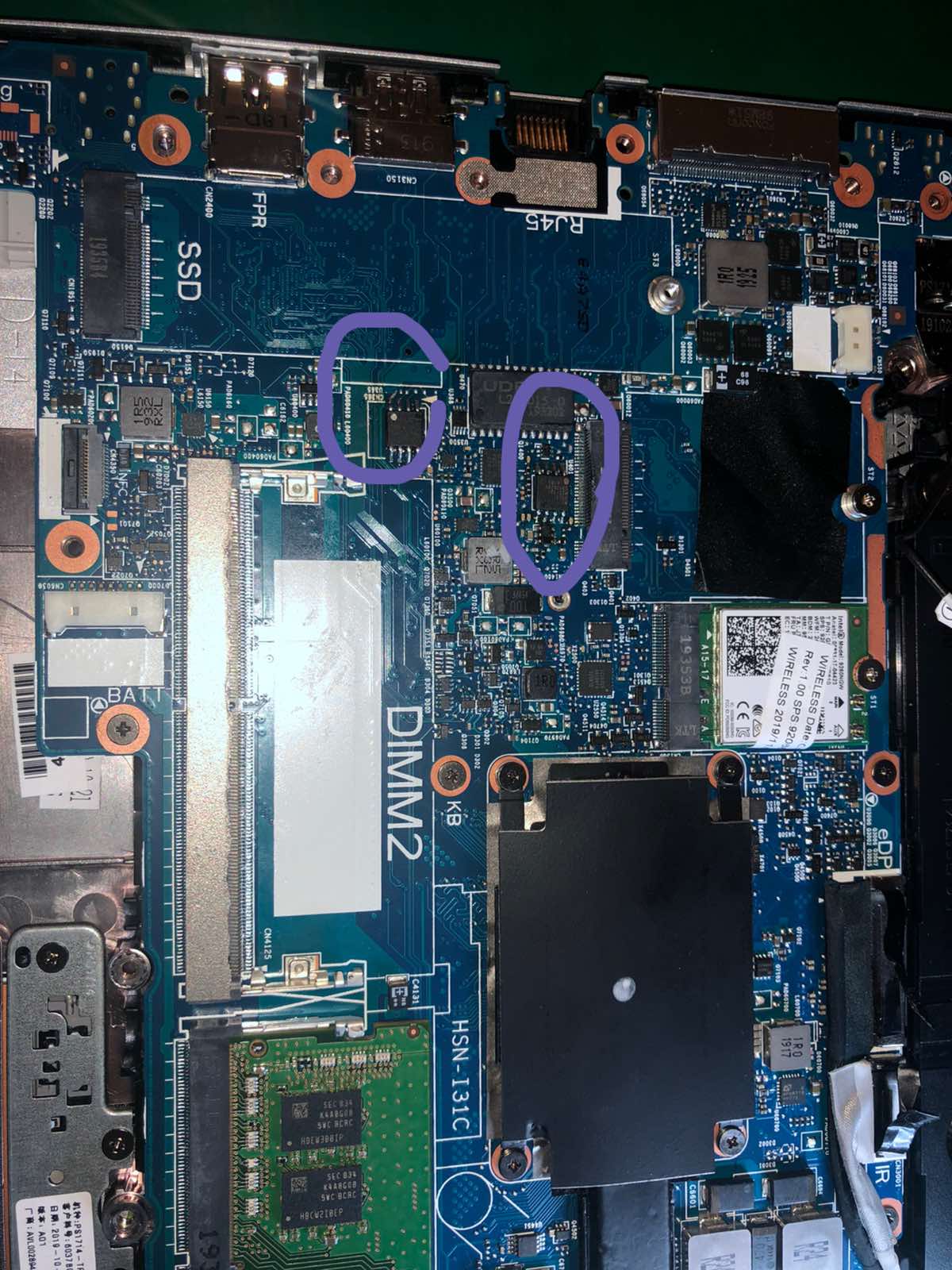

Can send me the way you program and the chip location you programmed?
Now i see,i have 3 chips,two of 25q128 and one 25q16,second 25q128 is on other side of board,i did not see that earlier
viber_image_2020-03-26_09-18-21.jpg viber_image_2020-03-26_09-28-14.jpg viber_image_2020-03-26_09-28-30.jpg
two chip 128 ?
You may have mistakenly made it to the BIOS I sent it not working
BIOS this 100% unlock ok
yes have two 25q128 chip,second chip which i sent i did not change i read him first time now.First file lock which i posted is U365, and lock 2 which i posted last is U366.
You are confusing me.
Can you make a full video from when you program the BIOS I provide until the computer is unlocked?
Wait i will explain to you.
I have 3 chip on board,U365 is 25q128 which i tried to change and program,second is U366 25q128 which is on other side of board,that chip i dont change,and the third chip is U401 25q16
Please Programming one BIOS this.
All remains in the original form, please program the correct CHIP.
If possible, create videos when programming and make sure your laptop has a lock screen before programming
sorry i had to shoot from two shots

you try Programming it for chip U366 :(
1.i dont understand you,i programming chip u365 last time with dump unpass
2.you think i need to program u366 with your unpass dump or what? because u366 and u365 are so different
3.have you look my dump r74,i programmed with that dump and still have password
i unlocked so much hp,lenovo,apple... laptops,but with that laptop i have so much problems,i tried everything,thats why i posted here on the forum
I mean return bios U365 with original bios and programmed bios i send to U366 chip
Yes, I also find this computer very strange, I have not seen any HP computer using two 16MB chips
