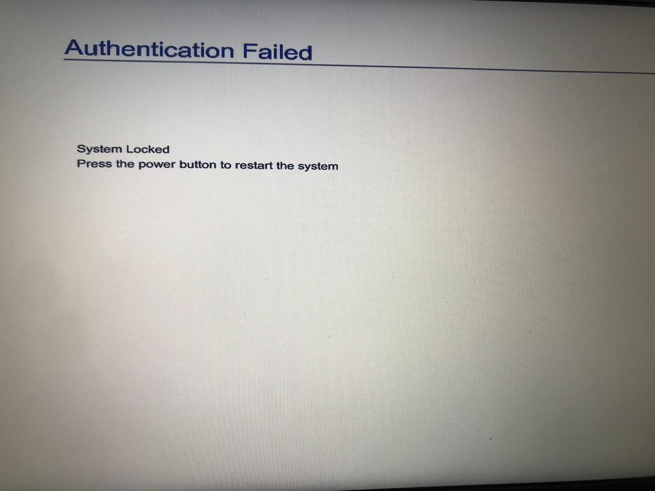

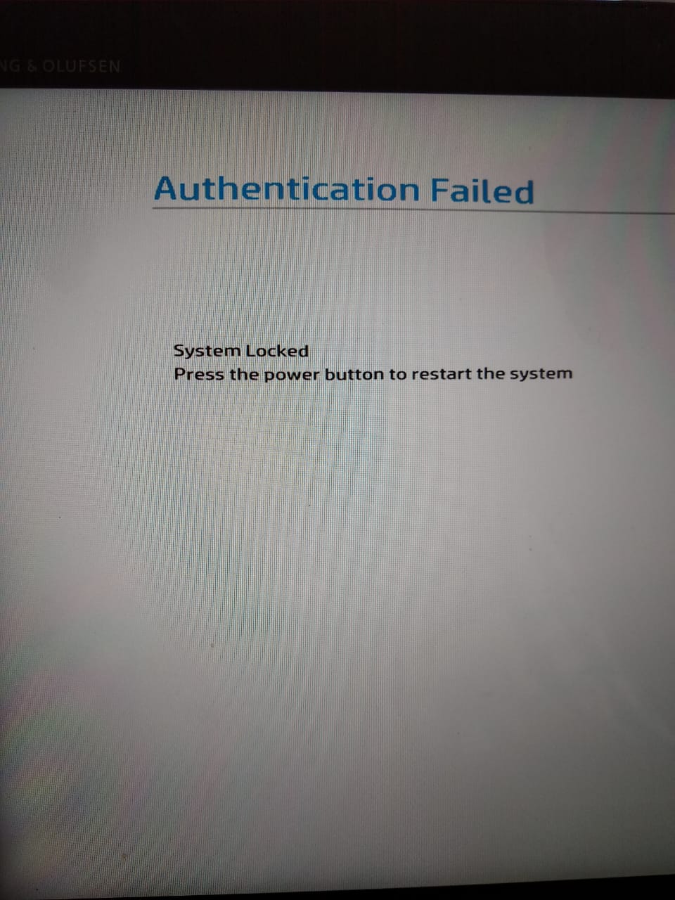

not working.fan runs on high speed
not working why request unlock :fou: (fou)
Please downloads again bios you send here
and make one video you Programming it and display lock i check.
I suspect the programming tool or the BIOS you sent is not good

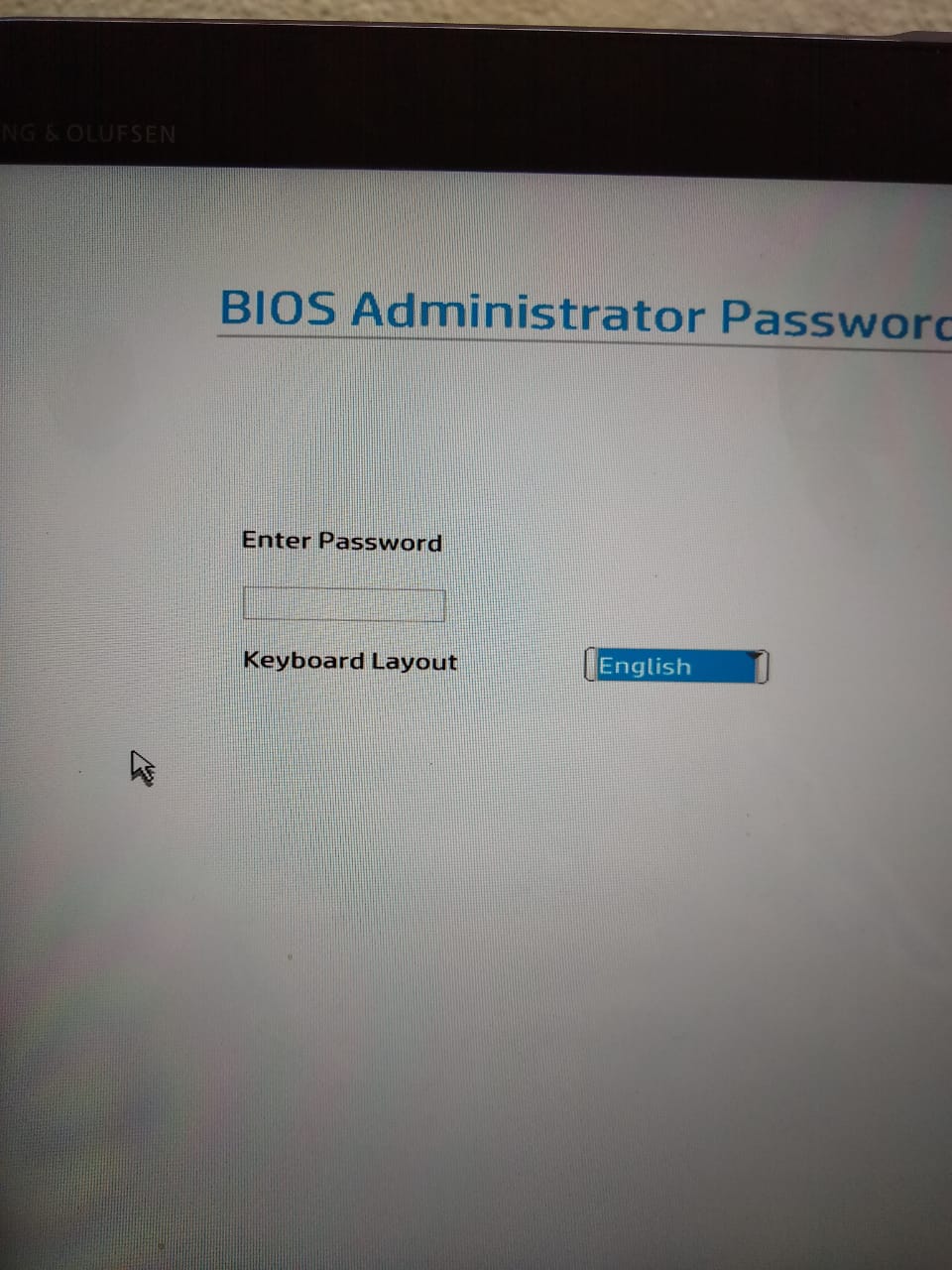

the bios i sent above is with ok display but have bios password.the bios you sent or others on this forum does not gives display. i m sending again bios with ok display but have password.
orig 8 pwd.BIN
orig pwd.BIN
