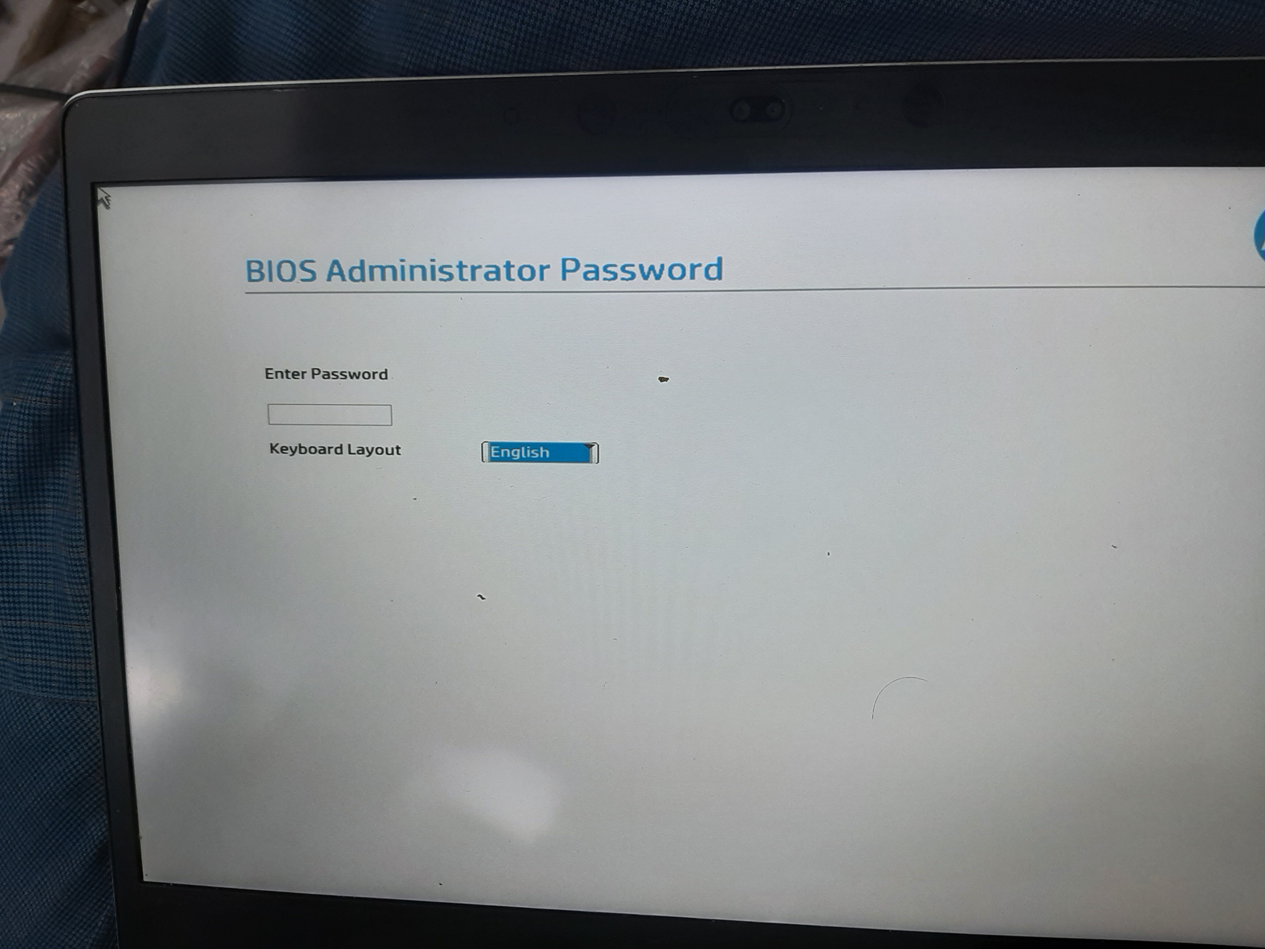

The file above kill my machine to .only blings the charging led and the power led 2 times .i flashed back the original bios now its not start
Above there are many other bios you can try more, but I think your programming tool is not good, leading to corrupting the original BIOS.
Hi I need information about what resistor I need to put in that place, the original one flew off when I soldered the bios. I tried to put another one but now the laptop turns on for 3 seconds and then turns off and back again with no image.
If you have a boardview it'll help me.
MB version: 6050A2930901-MB-A01
these 2 resistors are same value brother 22.7 ohm showing on meter
