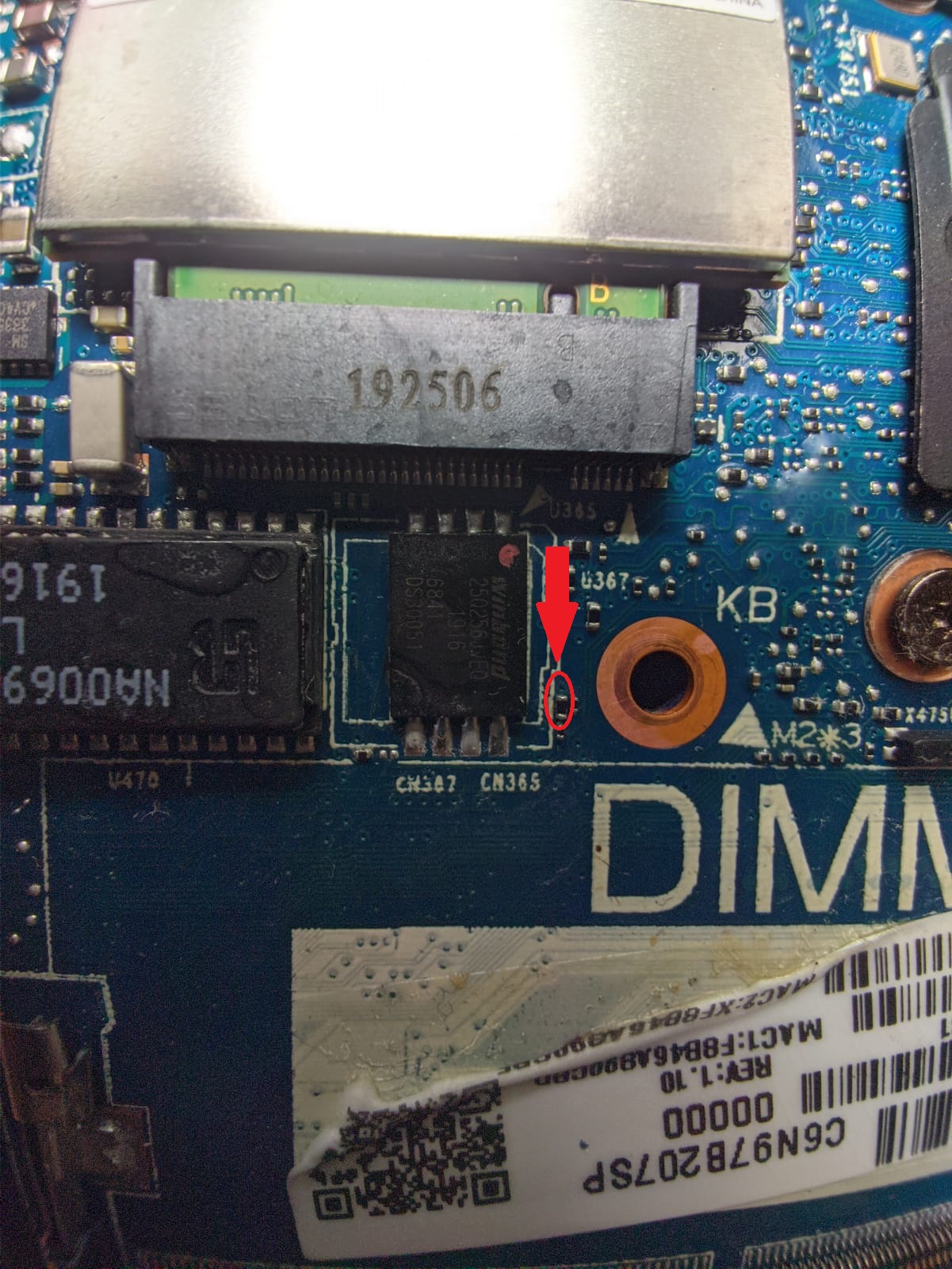

HP EliteBook 830 G5 6050A2930901-MB-A01 photo
Hi I need information about what resistor I need to put in that place, the original one flew off when I soldered the bios. I tried to put another one but now the laptop turns on for 3 seconds and then turns off and back again with no image.
If you have a boardview it'll help me.
MB version: 6050A2930901-MB-A01

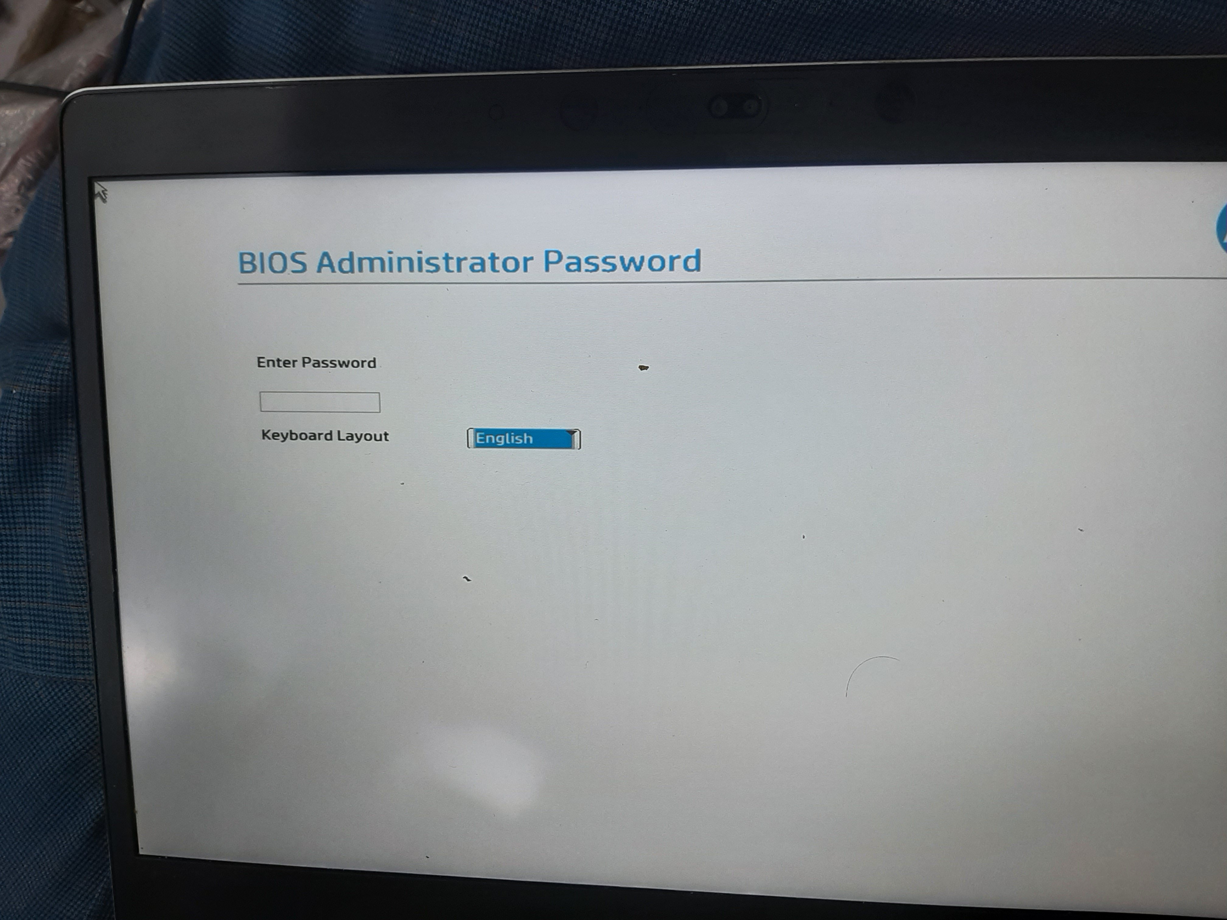

I tried your versions but now laptop does not display image only the leds are turning on and off, even with the original bios it's the same. I attached the original versions
HP Elitebook 830 G5
MB: 6050A2930901-MB-A01
old bios have display ?
Yes before first try with your bios, but after that no display, even with old bios. Old bios also has password.
I managed to fix the motherboard, and now it is working with a bios from someone else without a password but it's slow boot. I tried and the original bios is not working, can you fix my original bios?
