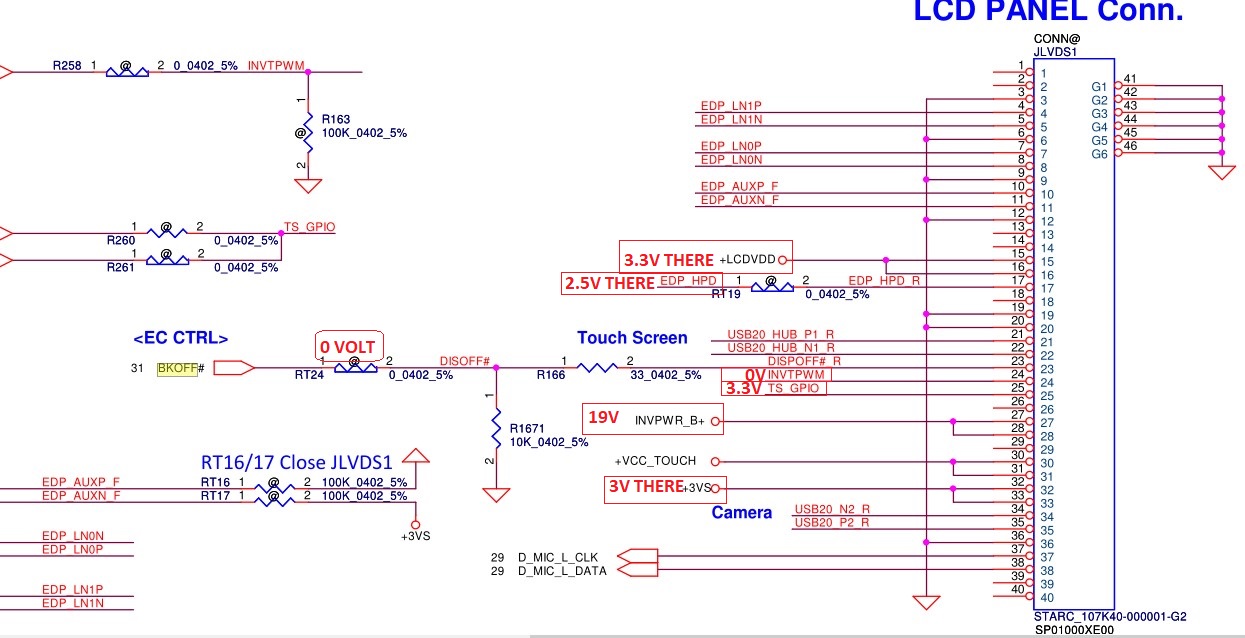

Hi, i have same model la-d704p
customer tried to replace the screen himself and damaged something . whenever you put new screen and with new lcd cable the screen goes dim black but doesnt display anything on the back no letters no anything. so no backlight and no display post. i have gone through all signals and i can see all of them comes fine but i cant understand why it doesnt display any post. HDMI display everything fine but not the main screen. i have attached a photo with all signal and powers i get . can somebody help me to resolve the issue/?
Motherboard model i have it only have APU no intergrated gpu .Annotation 2020-02-08 005644.jpg
