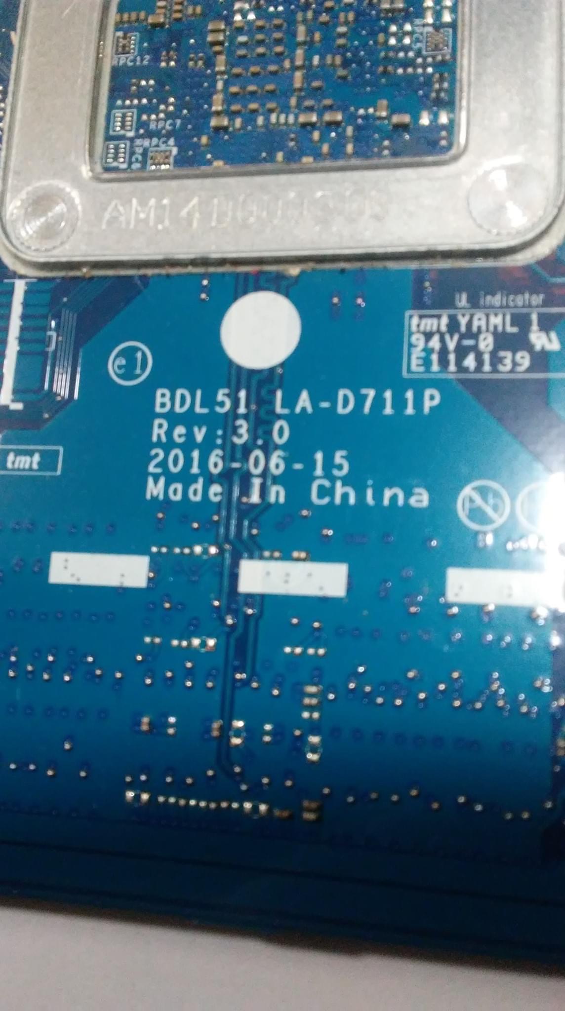

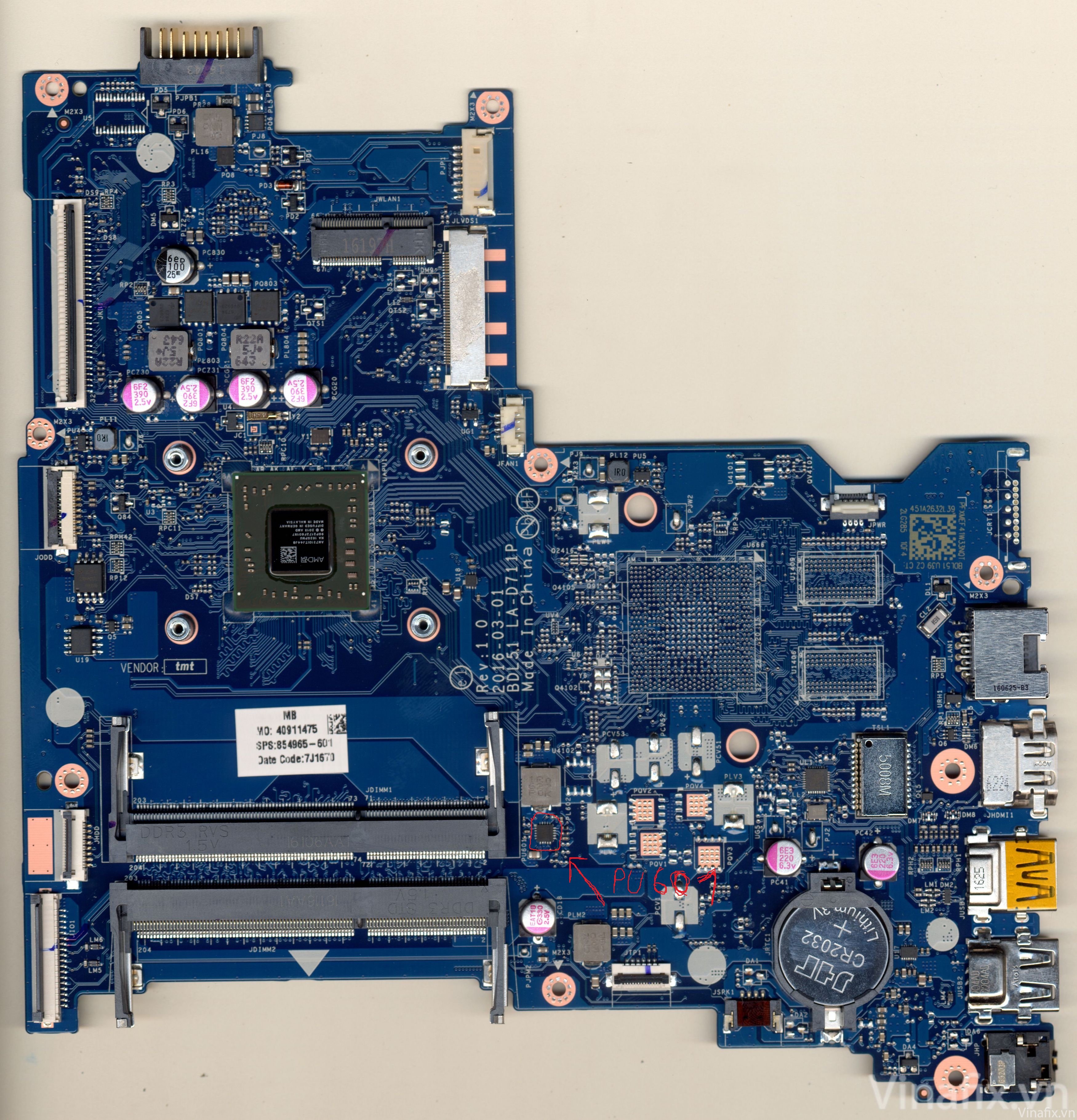

i don't know why you say revision 1 work on revision 3 , since it won't work !!! tryed it at fast fan and black screen all the time and shity consumption 0.40 amp .
here it is a WORKING bios for REVISION 3.0
insyde you have the 4 different BID for this equipment ,
BID081F5 is the bid of you bios for revision 1.0 and also the same bid as my original bios , and it only worked with the bios im uploading now , for revision 3.0
i love u man
i tried all vinafix bios
no one worked
i just fed up with this motherboard La-d711p
and than i final try with your bios
and your bios worked
i am very impressed with you
you are a genius :heart: :heart: :heart: :heart:
