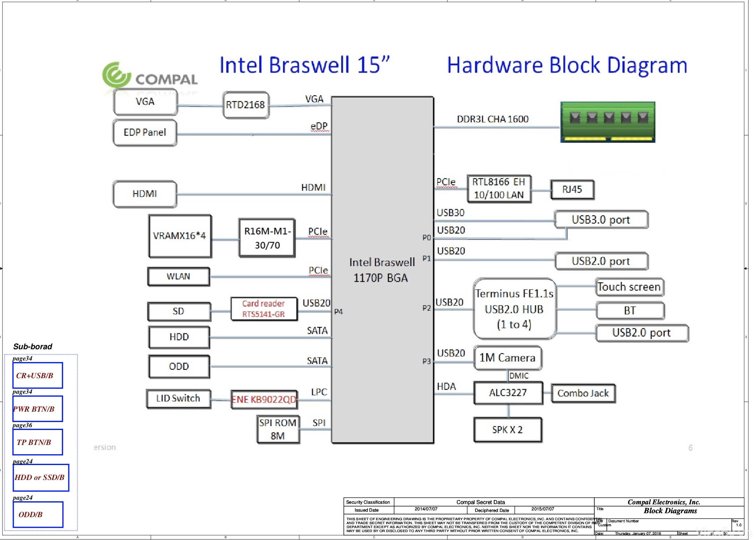

Hi , i have same model
BDL50 LA-D702P
bios version is BID081F2. the laptop powers on and the caps lock blinks 3 times. as per hp codes it say its ram issue . I have replaced 4-5 different rams ddr3 and ddr3L but still the same. i have replaced the Ram module slot just in case but still the same, i have reprogrammed bios but still the same. could it be the CPU/PCH issue? there is no GPU on that model

you have save old bios send i help check.
which chip use 1.8v[ i think you mean bios chip need 1.8voltage)? My ram voltage is 1.375v . cpu/pch is 1.008 volt
I just tried the bios and it still the same . blinks 3 times
not related to bios files, just pay attention when programming
well the programming goes fine and programs the file . i have the SuperPro model 610p programmer . it automatically voltage adjust for the bios IC . whats the solution on that one now?
after Programming laptop have problem what ?
It does exactly the same powers on and keyboard caps lock blinks 3 times.
When you put the power pin inside the motherboard the lcd blinks once and then whe nyou power on it doesnt display anything but all COILS have the required power
need check chipset.
