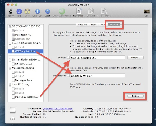

  4. Now select the formatted USB drive from the left side and click on the “Restore” tab
  5. Drag the previously mounted “Mac OS X Install ESD” image into the “Source” section
  6. Drag the formatted partition to the “Destination” section, then click on “Restore”
  7. Create the OS X Mountain Lion Installer
  8. Confirm that the USB drive will lose it’s data and enter the Admin password when asked
Disk Utility will now create a bootable OS X Mountain Lion installer drive out of USB drive using the disk image, this can take a little while depending on how fast the drive and Mac are but 20-30 minutes isn’t unusual.

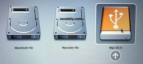

When finished, reboot the Mac and hold down the Option key to bring up the boot menu:
Mac Boot Screen
