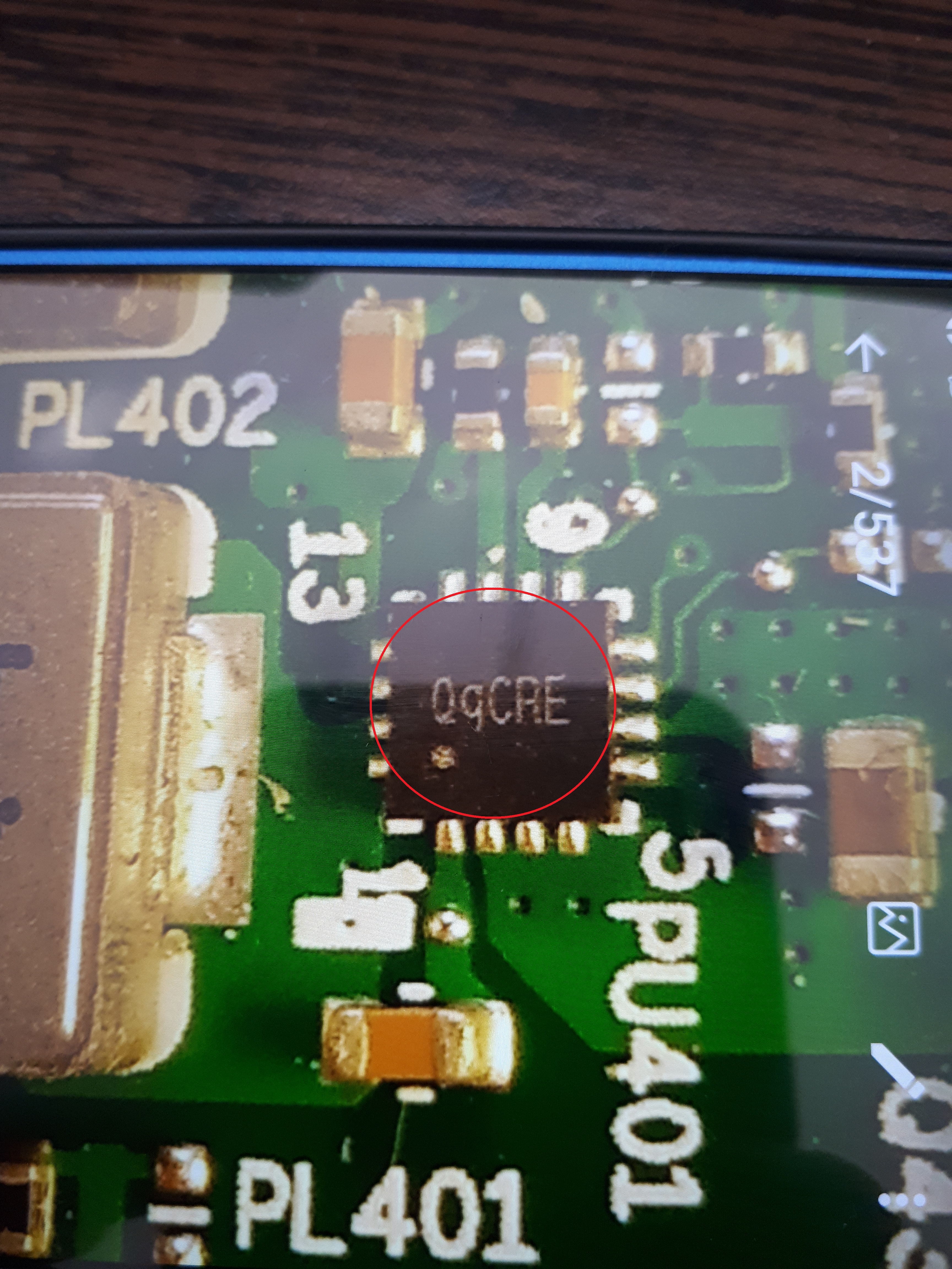

Hello.
I cant find board view or schematic for MB NM-C821
I need to know what is one perticular BGA device.
It is written 0qCRE but i cannot find it anywhere.
Maybe You can help to identify this device.
Thanks
