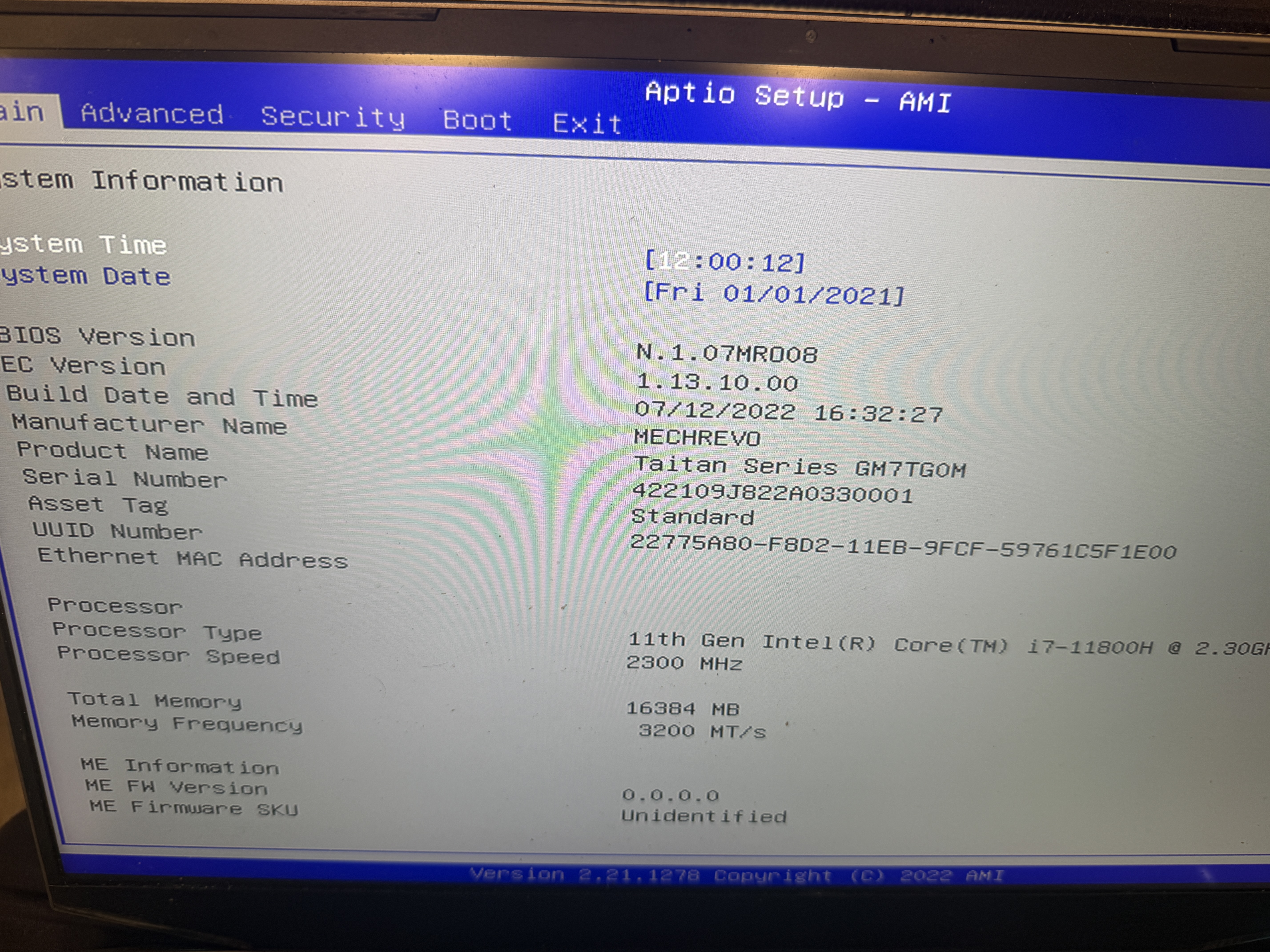

just an nvme problem? Are you sure because it won't fix other errors if any
As mentioned initially, the ME Firmware Version shows as unidentified and ME FW Version as 0.0.0.0. Regular SATA SSD are detected but do not boot. I tried with Linux Live USB, also no boot. I assume its because if the missing ME Version.
Bios with Clean ME do not POST, it hangs, so i dont know what to do anymore
