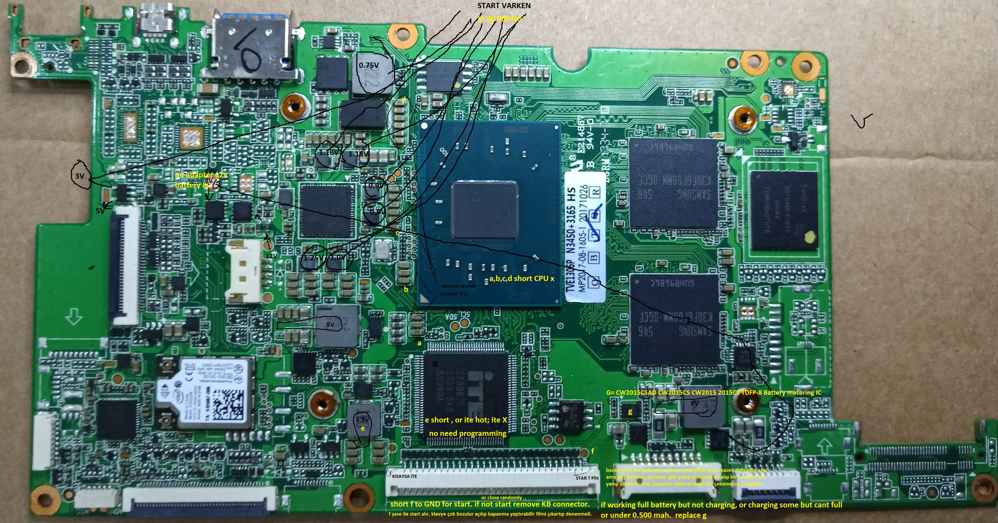

I'm attaching some pictures and old bios (no display, just blue led)
Hi in my Country same model we repair many many times this one. Try my bios files too , if board starting but no video remove keyboard pins start again with jumper keybard start pins. İf stil not Try micro HDMI to HDMI no video ? CPU chip! , if yes lcd broken! . And check my board picture too. There is some infor mation.
