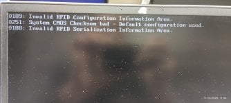

My laptop lenovo BIOS is corrupted and unusable. This BIOS boots on my Lenovo, but shows some errors on the screen: Does anyone know how I can fix it? I don’t have the original BIOS dump, only some data in TXT format.
post data when laptop are ok:

Type: Laptop System: LENOVO product: 20KQS00100 v: ThinkPad E480
serial: PF1111DD
Mobo: LENOVO model: 20KQS00100 v: SDK0L77769 WIN serial: L1HF7CB008A
UEFI: LENOVO v: R0PET63W (1.40 ) date: 01/03/2020
