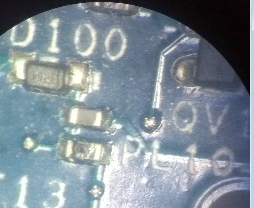

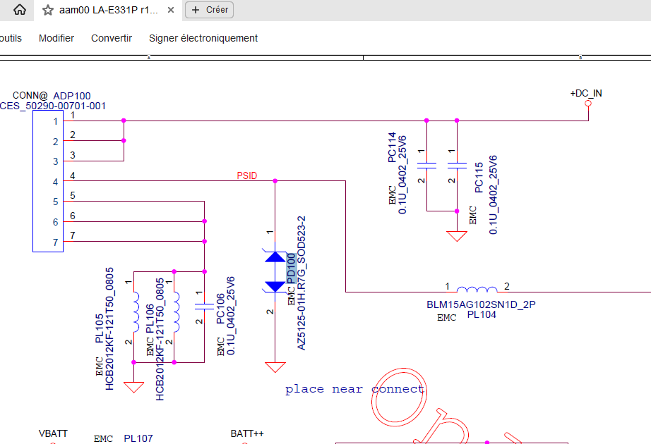

i am looking for value of a resistor near PD100 and PL104
on my board the resistor is betwin this 2 componants, but on the PDF file it does not show??
the resistor on PSID is burned
i need value for replacement
ty
edit

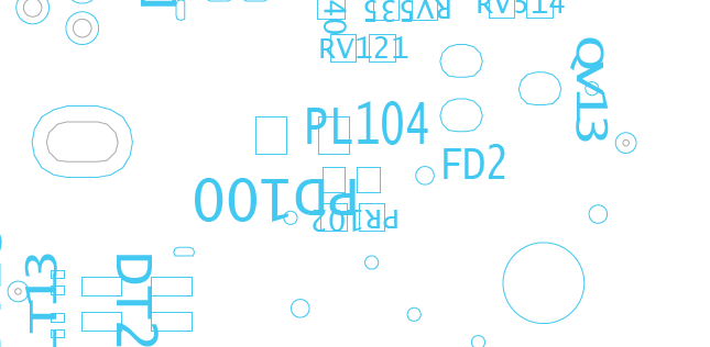

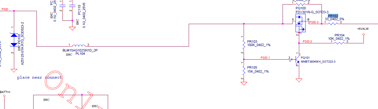

on LA-e331P TOP.pdf i get a name PR102
but i do not have the components in betwin from the first file
same resistor value 33 ohms ?

EDIT :
ty
edit
it is a ^pain in the neck when pdf do not match exactly.
EDIT
33 ohms worked
laptop boots again.
ty
