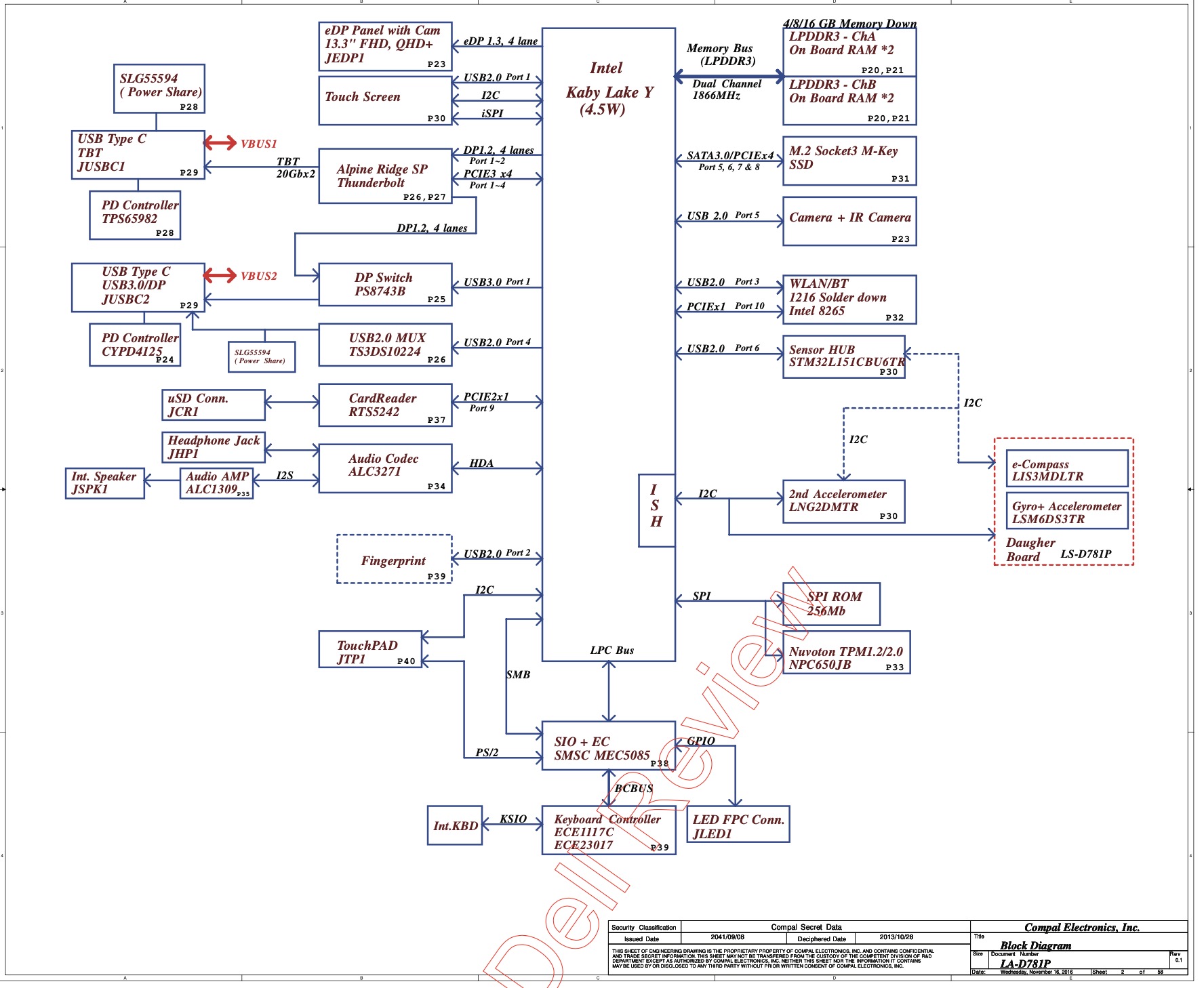

Dell XPS 13 9365 BAZ80 LA-D781P BIOS
Dell Inspiron 15-5566 LA-D781P rev 1.0
LA-D781P_aventador_mb_20161116.pdf

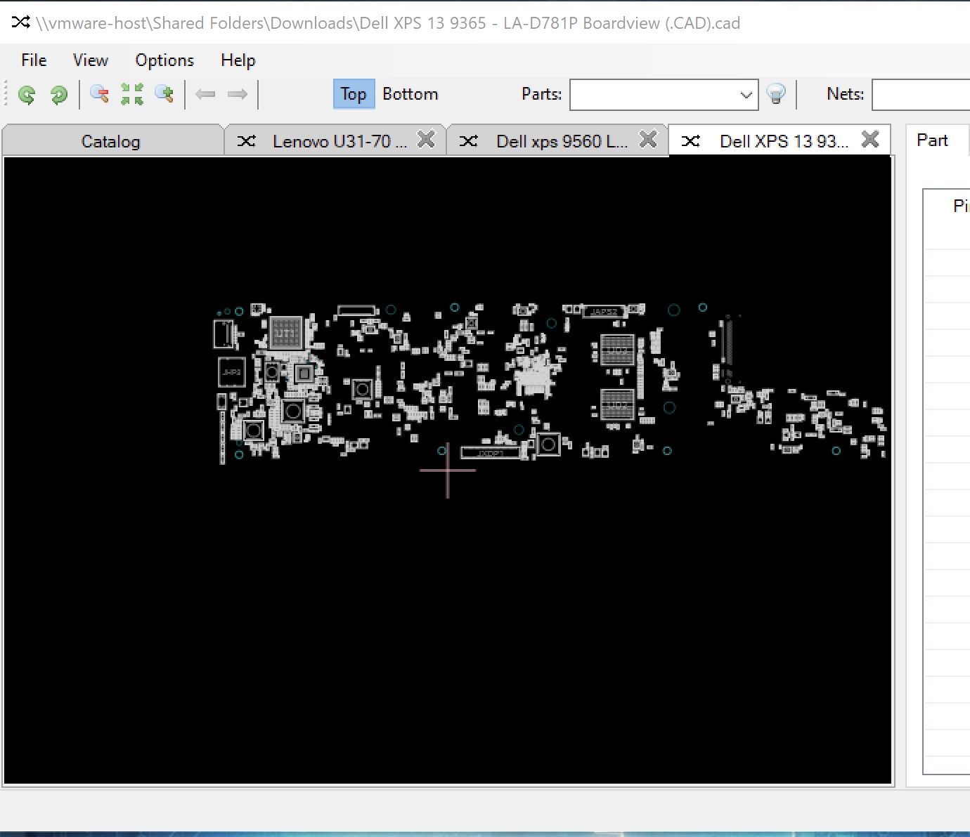

Dell XPS 13 9365 - LA-D781P Boardview (.CAD).cad
Schematics boardview BIOS
boardview
