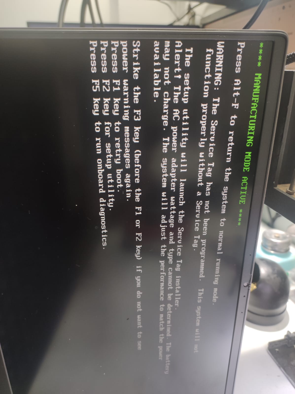

cuenta2020 Registered member Sep 30, 2022 #1 EXCELENTE DIA, AYUDENME CON ESTA BIOS NO DA IMAGEN, PLEASE CLEARME Download list U2501.bin 8 MB · Views: 44 U2503.bin 16 MB · Views: 58 Upvote 0 Downvote
D Dinesh Yadav Active Member VIP PRO Nov 26, 2025 #21 ThienBui said: 11613 main bios.BIN Click to expand... no display with this bios the old one have only fan issue
ThienBui Techniques Supporter Nov 26, 2025 #22 Dinesh Yadav said: no display with this bios the old one have only fan issue Click to expand... model this use two BIOS you can Programming both bbbbb.zip
D Dinesh Yadav Active Member VIP PRO Nov 26, 2025 #23 ThienBui said: 11613 main bios.BIN Click to expand... no display with this bios the old one have only fan issue
D Dinesh Yadav Active Member VIP PRO Nov 26, 2025 #24 ThienBui said: model this use two BIOS you can Programming both bbbbb.zip Click to expand... still no display after programing both bios
ThienBui Techniques Supporter Nov 26, 2025 #25 Dinesh Yadav said: still no display after programing both bios Click to expand... next check hardware
D Dinesh Yadav Active Member VIP PRO Nov 26, 2025 #26 ThienBui said: next check hardware Click to expand... i programed old bios again and system run perfectly but fan run faster so this is bios problem
