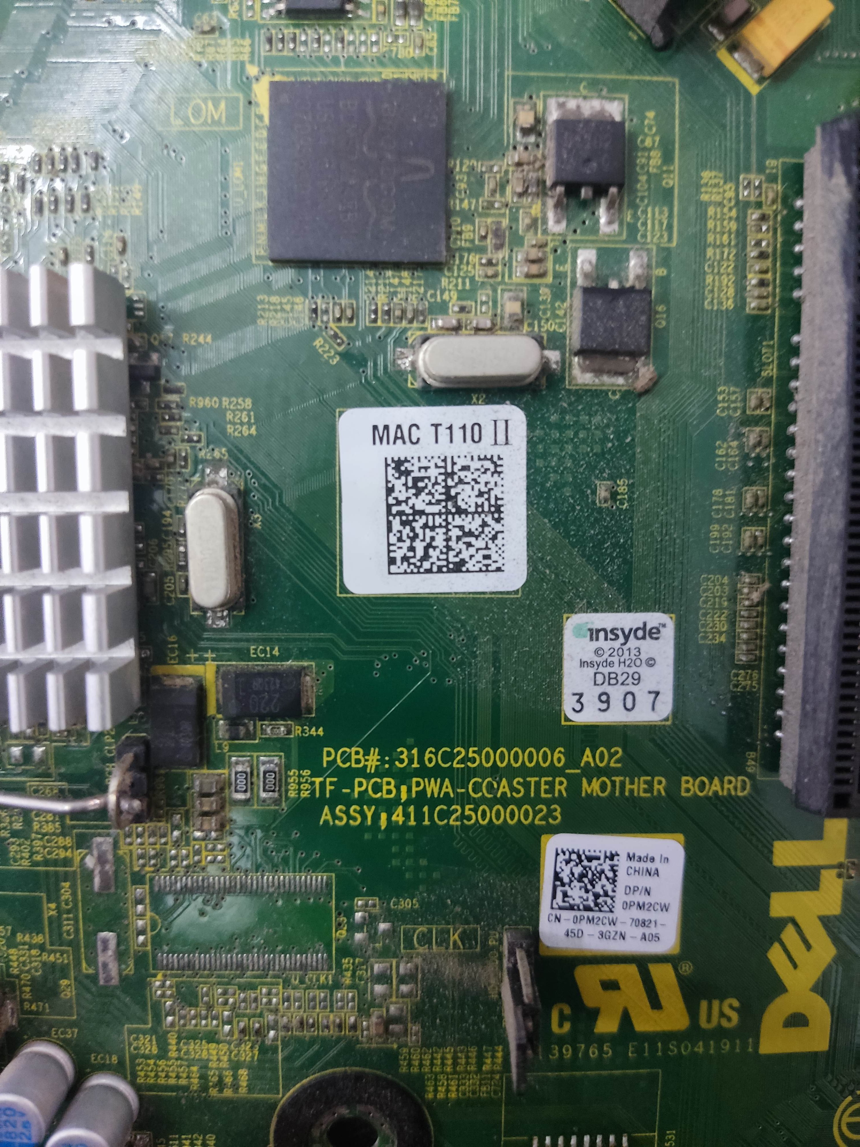

G Gunjanksh99 Registered member Feb 21, 2022 #2 no display 316c25000006_a02 Download list 316c25000006_a02.BIN 16 MB · Views: 8
ThienBui Techniques Supporter Feb 21, 2022 #3 Gunjanksh99 said: 316c25000006_a02 Click to expand... not right servie tag ?
ThienBui Techniques Supporter Feb 22, 2022 #5 it's not search by model or service tag If you don't listen to me, find it yourself
ThienBui Techniques Supporter Feb 22, 2022 #7 Gunjanksh99 said: no display 316c25000006_a02 Click to expand... I checked it's not BIOS double check and correct BIOS backup
ThienBui Techniques Supporter Feb 22, 2022 #9 BIOS main is 8MB downloads here BIOS - Dell PowerEdge T110 II 316C25000006_A02 PowerEdge T110 II main bios is 8MB 316C25000006_A02 vinafix.com
