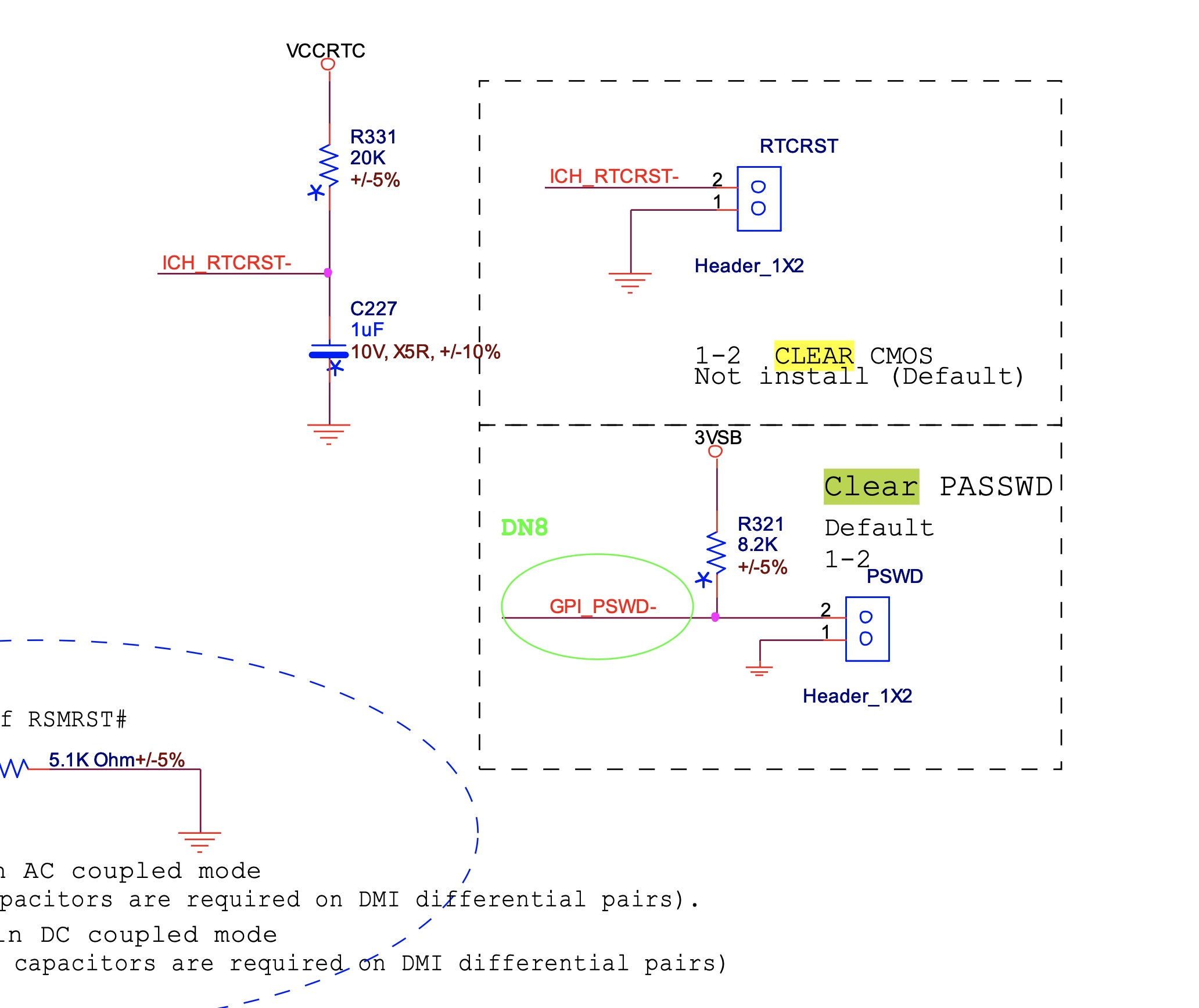

clear me please
Clear Me OPTIPLX 990 BIG

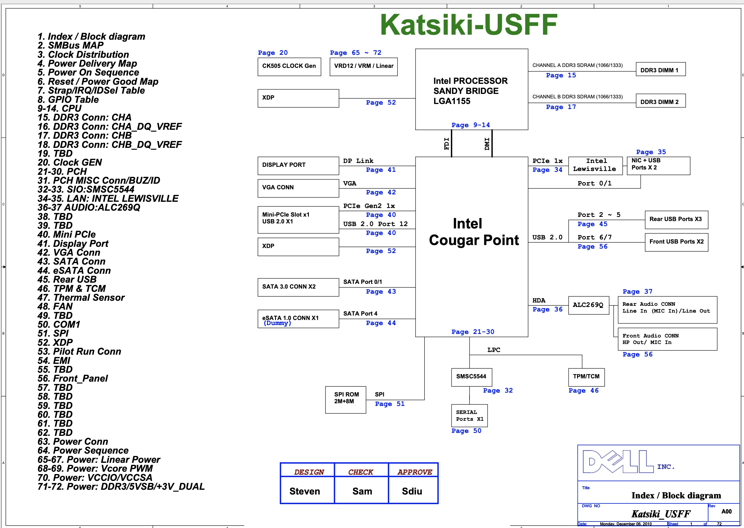

Schematics Dell OptiPlex 990 - Dell KATSIKI-USFF rA00
