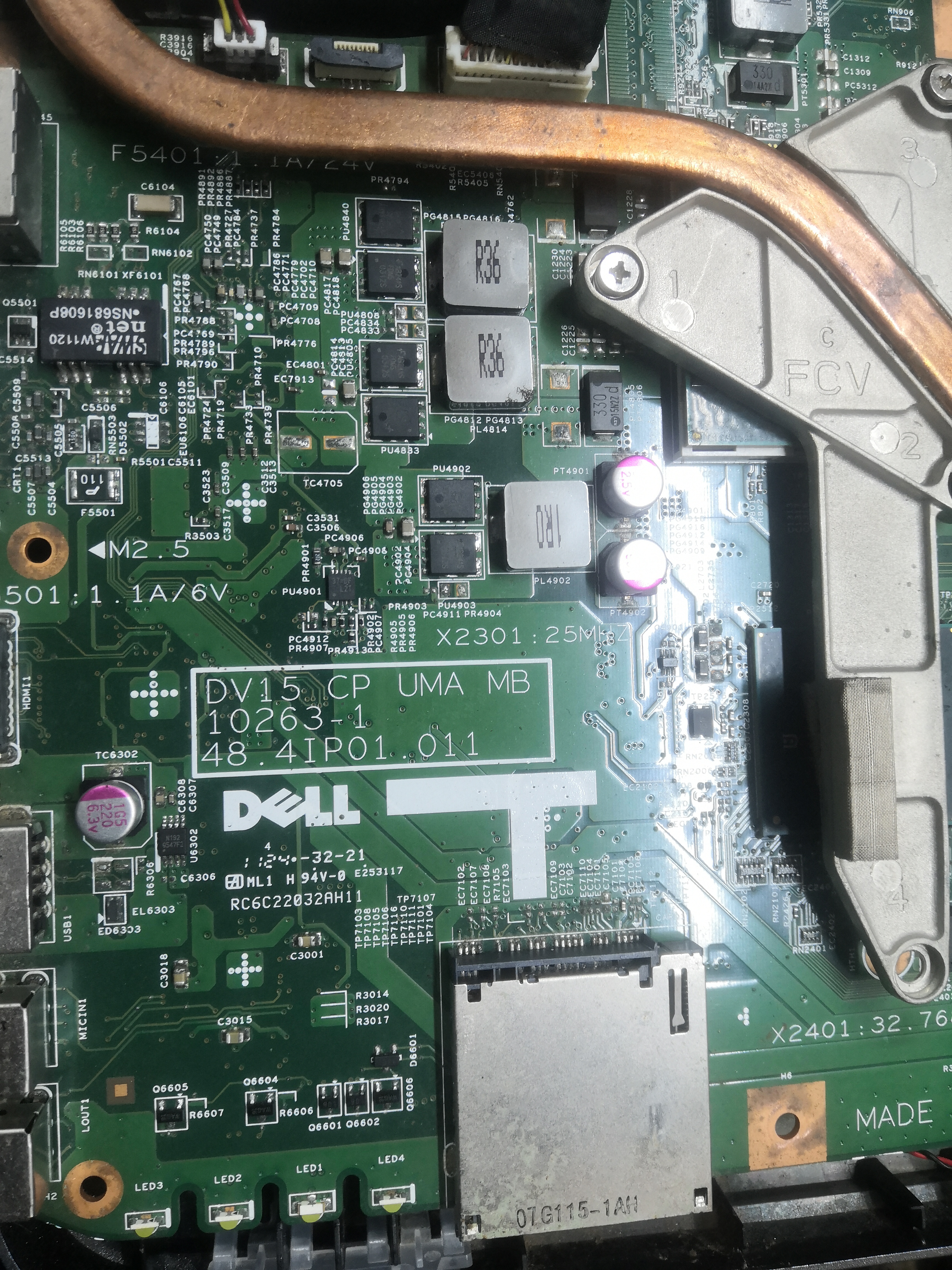

Can u Re upload the EC Bios for 10263-1 .Laptop Issue No Display after Programming This Bios Not Powering On N5040
Please help...
kbc IO NPCE781B pin no:15 GPIO36 S5_ENABLE 3v voltage absent. is it io problem or not?S5_ENABLE link to enable pwm 5v 3v . 5v 3v absent now. will i need to program EC?
Please help...
I/O this no have rom
If you doubt it, you need to try a new IC
I know IO NPCE781B not programmable io. EC bios control KBC or io . i mean is it problem for ec bios programme?
S5 enable control EC bios 2mb? SPI FLASH ROM (2M bits) for KBC. startbtn voltage ok and other. is it non programable IO problem? is it replace for this reason?
