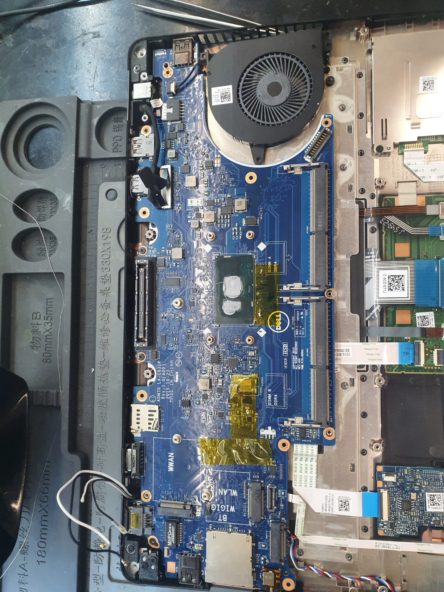

hi sir i need your opinion
i have an dell adm70 la-c631p
came in whid no image
programed 1º bios - have image but after 1º start dos not boot anymore
programed 2º bios - have image and boot everytime, but wired and wifi conection dont work and batery dont charge,
can you help find the corect bios for this

whid your clear me , the problem is no image, same as original bios,
maybe if you clear me on 2ª bios i can have progress
