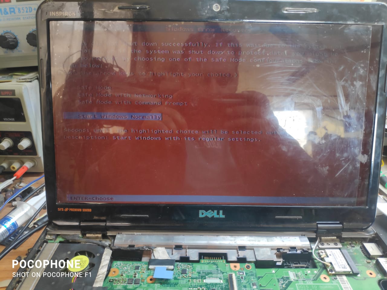

After modernization of the samostart plate, current consumption of 0.1A
No response to the switch.
Has anyone checked this modification?
It worked?
i used the paid guide on Dell 09909-1 n5010. laptop turns on but no screen.
the guide doesn't tell to add TPS51611_+GFX_CORE(UMA), and all the related components.
which is very strange, how the CPU GFX will work without GFX Core Voltage???
anyone done this guide with success?
SAME LAST TIME I TRY PAID METHODS NOT WORK VCC CORE SUPPLY NOT ACTIVE I TRY THIS METHODS WORKING WELL.
