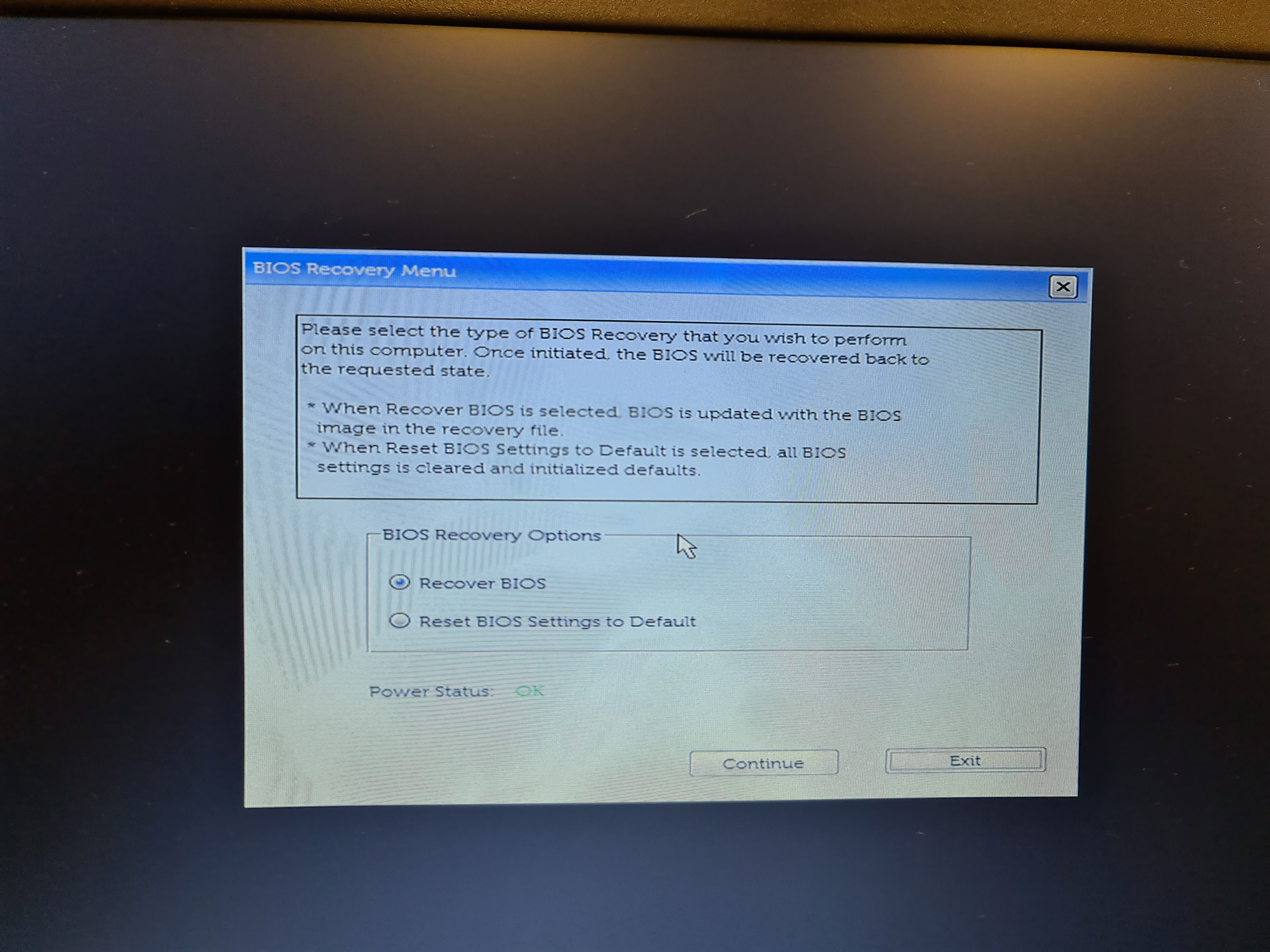

can you help rebuild my bios for GA-712P Inspiron 3583 because each time turn on we receive bios recover message and cannot get out of loop. I tried your v1.6.0.bin.zip this works ok but give me Dell Logo delay 30s
I tried clear mes.zip
when I enter my tag and upgrade firmware .. it now has delay.. when turning on..
caps lock light turns on then off twice same with Dell Logo before booting into Windows..
i have attached firmware.. can you help again
