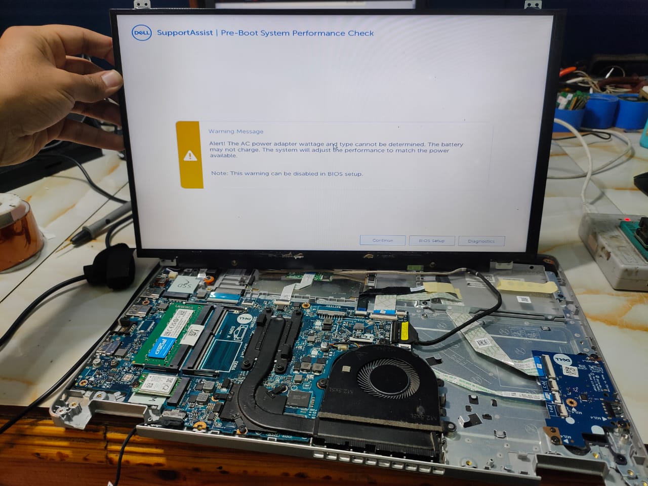

Check in bios setup charger show or not?
I think not detect id pin.Trace signal id pin and will find component PQ2,PQ3
you miss understanding
i mean i tried all bios here but it does not work i bought bios from another site it works for me.
i know i use charger lower than recommended
