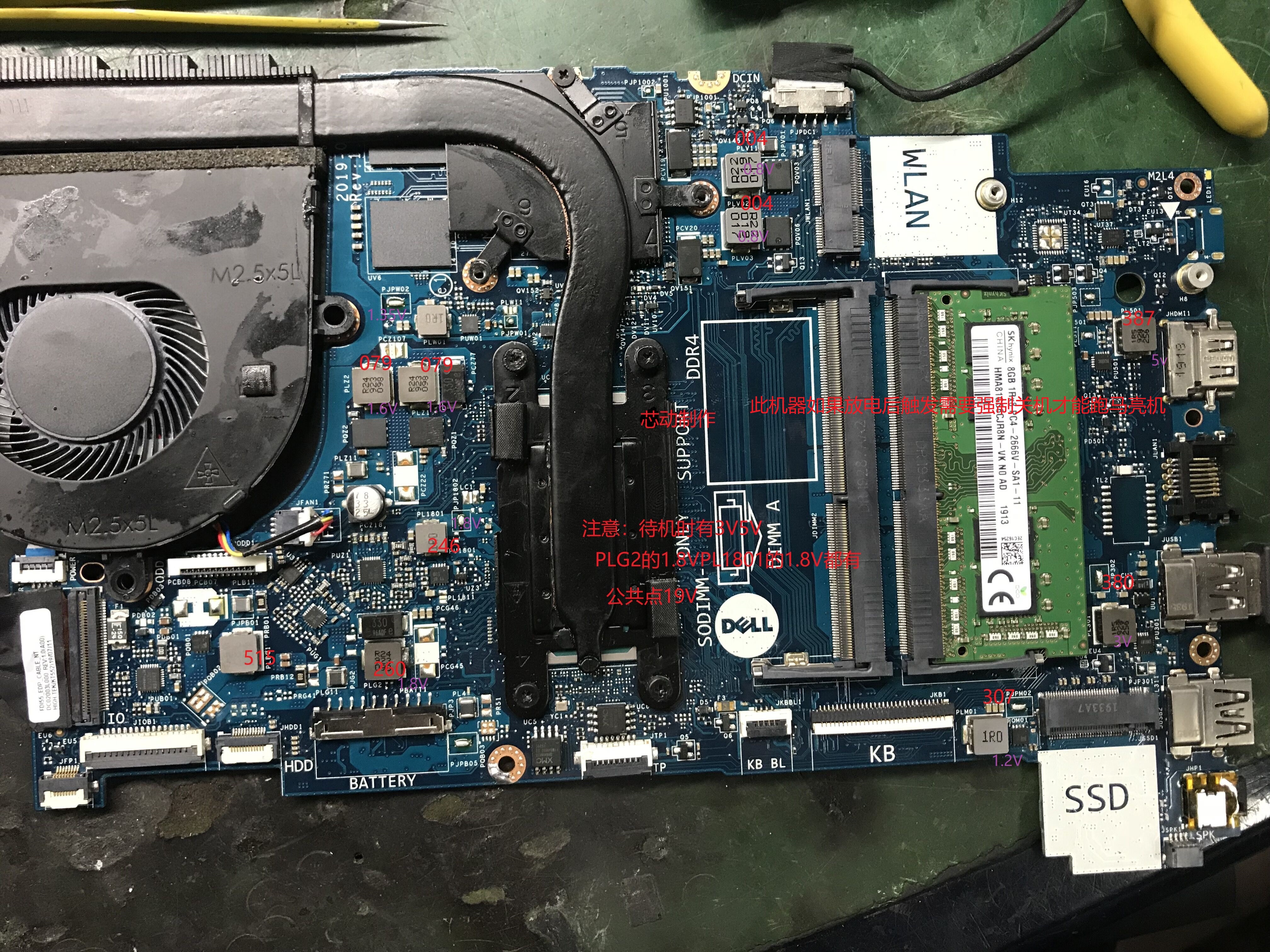

có mỗi 1 file đóe xin sơ đồ chuẩn của main la-j091p. sơ đồ ad up ở trên là mã main la-j081p khu vực mạch sạc nó khác ạ
bác fix giúp e lên chậm
FDI45 LA-J091P 1.0 (A00)
DELL INSPIRON 3793 reg( P35E007)

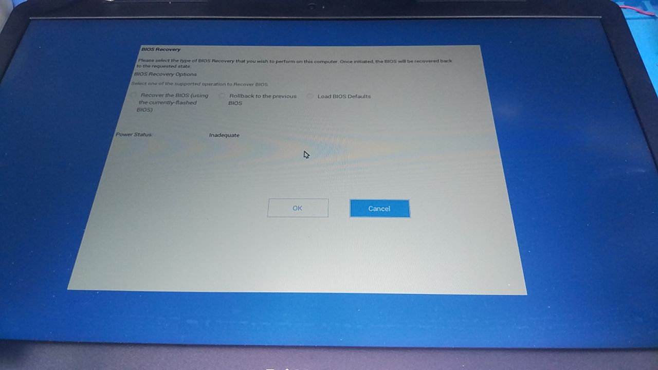

Turn on . No display.
Work only "Cancel"
didn't you say it was working wrong when pressing cancel?What can be done to make the laptop work? After clicking cancel, the laptop restarts and this window pops up again and again.
Nothing can be done beyond this window. Chose all three. Reboot and window again. BIOS cannot be entered. Can you clean up ME REGION? Suddenly help. Dump bios that I gave must be original, flash has not been soldered before.didn't you say it was working wrong when pressing cancel?
if it continues to show the message next time, update to the latest version from dell or look in BIOS setup and turn off auto update…
Original but it no displayNothing can be done beyond this window. Chose all three. Reboot and window again. BIOS cannot be entered. Can you clean up ME REGION? Suddenly help. Dump bios that I gave must be original, flash has not been soldered before.

Work! TPM error.Original but it no display
try bios this
FDI45 LA-J091P REV 1 0 WORKING OK 8MB.BIN
FDI45 LA-J091P REV 1 0 WORKING OK 16MB.BIN
TPM need buy patch 25$Work! TPM error.
Many thanks for the work done!!!TPM need buy patch 25$
