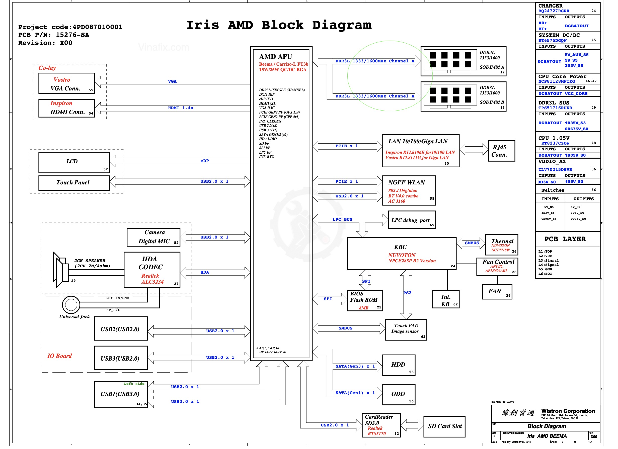

Schematics Inspiron 15 3555 15276-SA IRIS_AMD_schematic_X00

laptop after 15 minute shut down and when i restart laptop on with 7 beep and some time 3 beep
