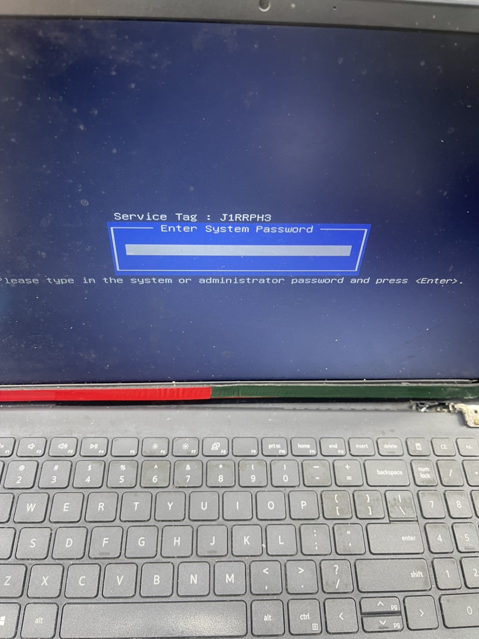

la-l244p clear me
file nào ?fix giup em lan wifi chám than
remove password pls
Password in I/O you need Programming it or buy master 22$ enter and doneremove password pls
can i send to your direct PayPal account 22$ to unlock this ?Password in I/O you need Programming it or buy master 22$ enter and done
yescan i send to your direct PayPal account 22$ to unlock this ?
OK I PAYED
You need to enter the wrong password a few times and it will display the codeOK I PAYED
IT HAS ONLY SERVICE TAG CODE .., 7S4THK3
ITS SHOWINGYou need to enter the wrong password a few times and it will display the code
Service Tag:7S4THK3ITS SHOWING
''SYSTEM PASSWORD ATTEMPS FAILD 3 TIMES
SHUT DOWN IN 5 MINUTES . PRESS F1 TO SHUT DOWN IMMEDIATELY''
AFTER PRESS WRONG PASSWORD FEW TIMES ONLY SHOW LIKE THIS
THANKS ITS WORK ...Service Tag:7S4THK3
Password:2582A35A
