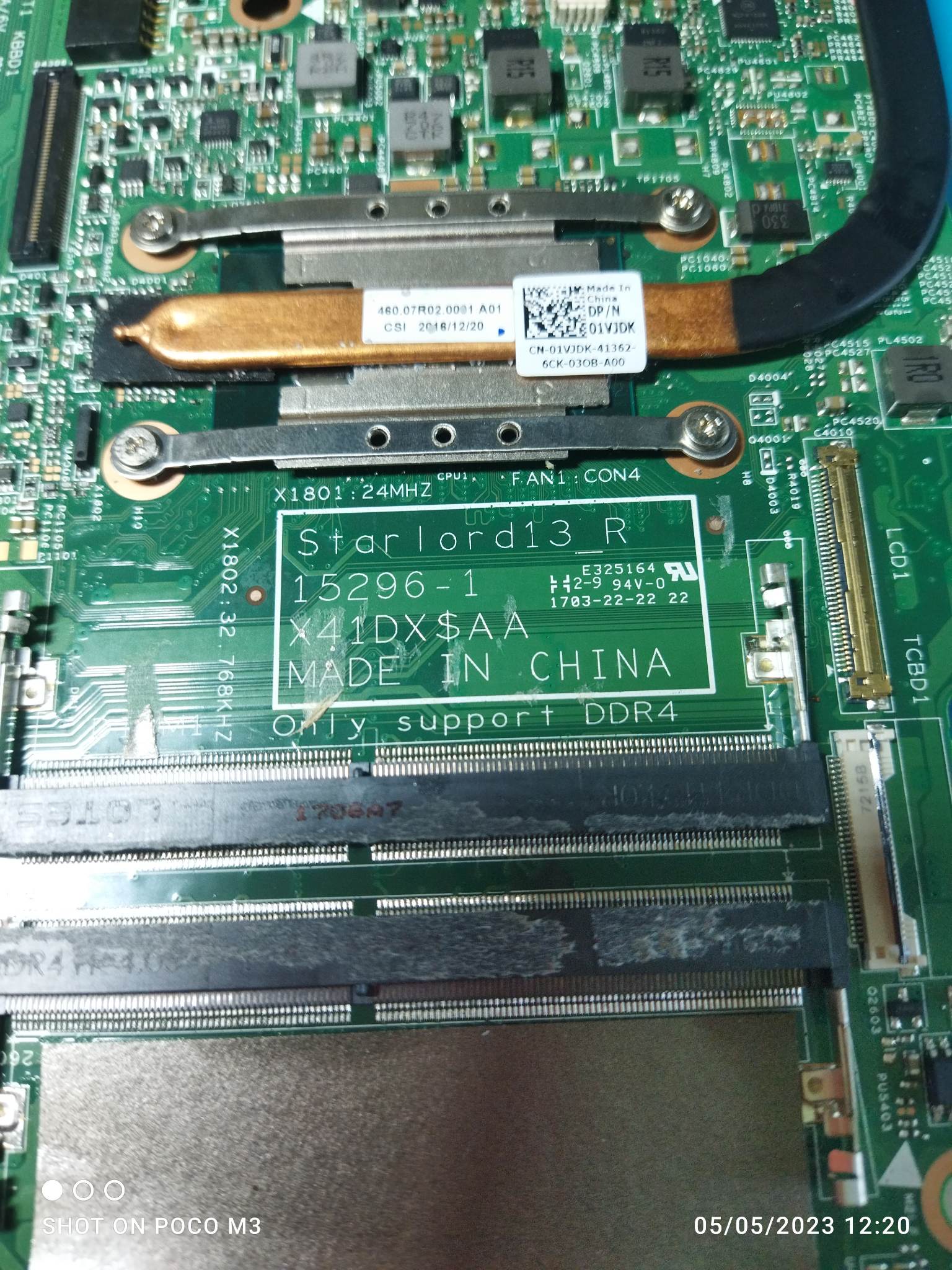

Have a nice day to all. I have a question about this Dell model Inspiron 13 5378 2-in-1 Is it the same Bios bin for this laptop? also compatible with this Dell Inspiron 13-5368 15296-1 BIOS 16MB. thanks for answer

yes, all same Motherboard 15296-1
Master Thank you for your Answer. anyway, I have Inspiron 13 5378 2-in-1 problem that is no display and the keyboard backlight is red only not active, and also the fan spinning fast. kindly please repair or clean the bios bin files here, I think it is a Problem bios firmwaUpdate
hello again. still have no display and the fan spinning fast. although have improved blinking a charging indicator also keyboard backlight turn off. anyways can fix this. need some advice - I already do this clean ram and also try another new ram but still the same . thanks

nạp lỗi ad ơi
034: Write successful£¬Elapsed time£º914.4 seconds¡£
035: Auto verifying...
036: Chip verification error, start position: 0x0.
037: Verification failure£¬Elapsed time£º3.272 seconds¡£
038: Status register1 values: 0xFC ¡£
039: Write error, operation terminated.
nạp lỗi ad ơi
file bios đâu có lỗi
bạn lấy đại file gì khác nạp còn dc chứ ko cần phải file bios
kiểm tra tool, kết nối chận hoặc IC
