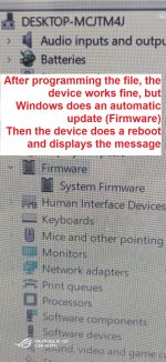

Thank you...
I'm not lazy but I didn't explain correctly
The file you sent is not working
Meaning the device was working and giving a message tpm erorr
And the file I sent was copied to the device and then it stopped working permanently
(no power):cool:
The same problem as before, after programming the BIOS, the device works, and when it does a firmware update automatically, the same message appears
If I disable the firmware from Windows, the device works fine, but I want to solve the issue in an island manner
if you let it update there will be an error i warned not to update the BIOS
