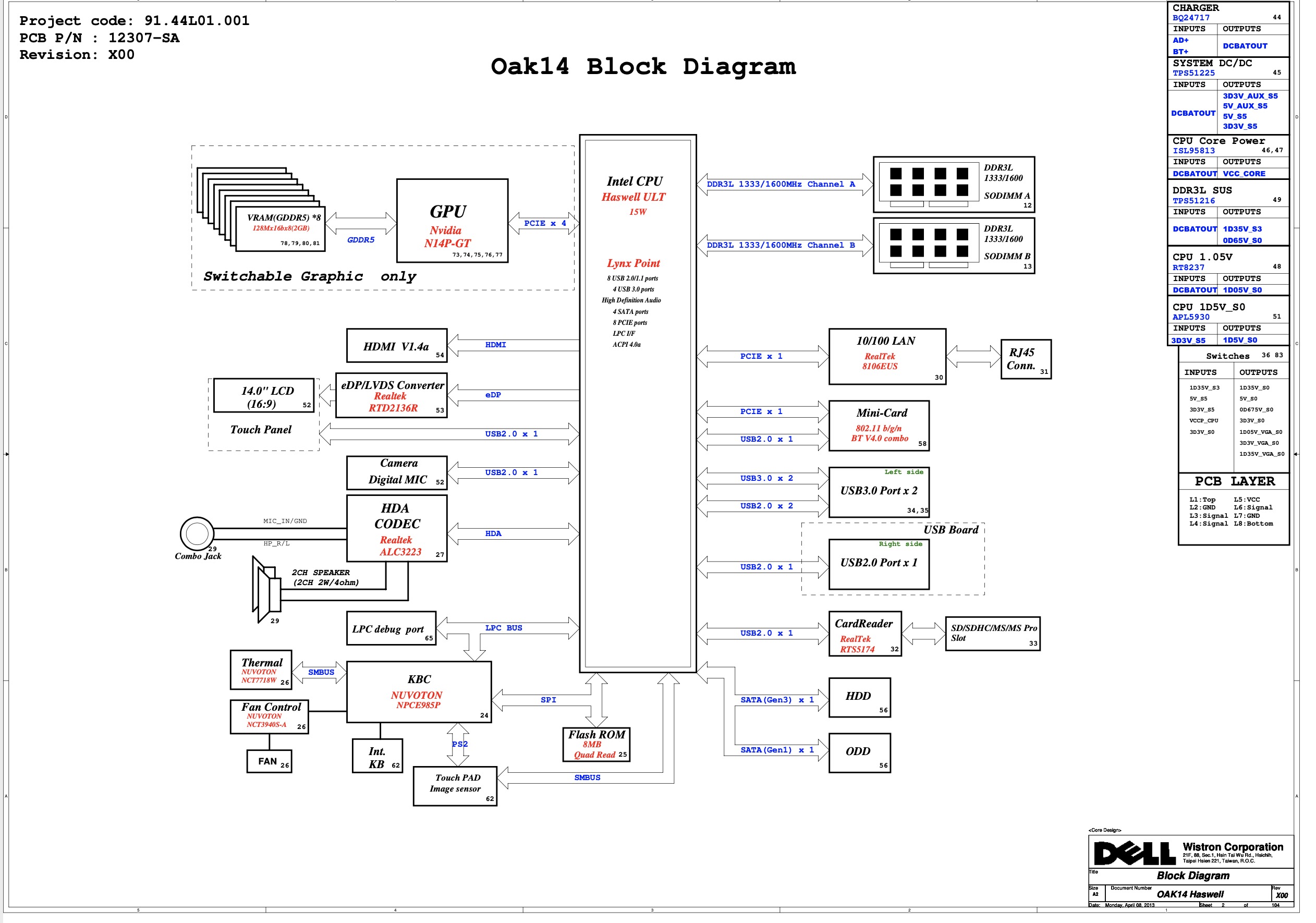

Hi! I replaced the NUVOTON NPCE285PA0DX, but the equipment doesn't work. The led turns on but the cooler doesn't turn on. You have the NUVOTON bin?
