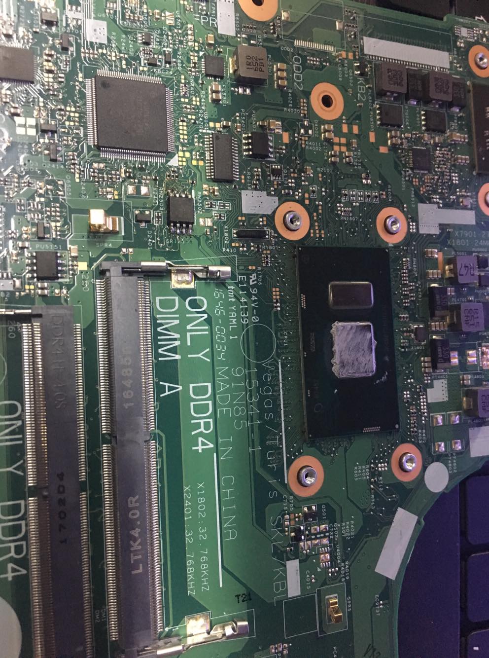

Dell inspirion 15-3567 Wistron VEGAS TURIS SKL KLB 15341-1 photo HD
