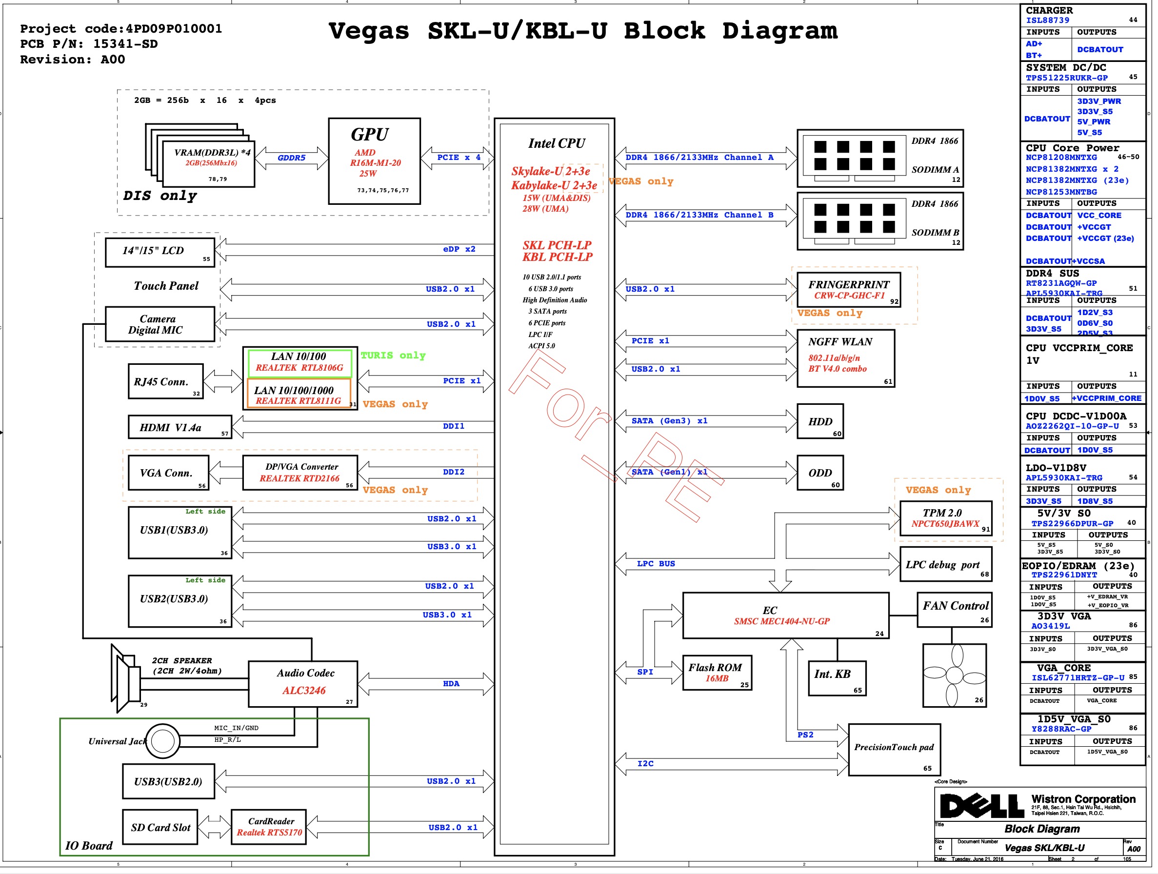

Dell 15-3567 I5-7200U 15341-1 91N85
Dell Inspiron 22-3263 System BIOS.
vegas/turis skl/kbl
15341-1 8MB
Schematics
15341-1 VEGAS_SKL-U_A00_0627_1
boardview
15341-1 BOTTOM.pdf
15341-1 TOP.pdf
15341-1.0628WZS1517.brd.zip
Dell inspirion 15-3567 Wistron VEGAS TURIS SKL KLB 15341-1 photo HD

It starts, the cooler operates at maximum speed for 1-2 minutes then resets and the phenomenon is repetitive, without displaying an image.
