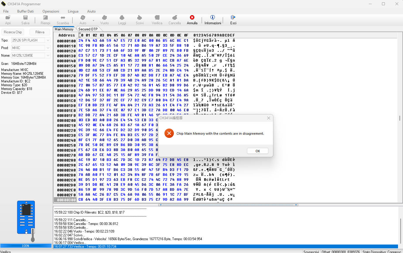

Good morning,
I have this bios of the Huawei motherboard "dah98nmb8c0 rev c", the power light turns on but I don't see anything on the screen, after a few seconds it turns off again.
I attach the original file and a bios file already recompiled by someone from technical support.
I'm writing to you again because I have a problem, I don't know if it's a bios problem or something I'm doing wrong and I can't understand the problem, I would like if possible (obviously paying) to understand what's wrong.
Initially I tried to reprogram this bios corrected by you on the original chip, during the writing phase everything was ok but during the verification phase it gave me the error that you can see in the photo. so I thought of buying new chips thinking that it could be the damaged chip, but the error occurs again even with new chips.
Now I wanted to know if it could have happened that the original file that I attach read by the original chip was already damaged and therefore even the repaired one can have problems so if you had a tested and working bios file to mount or some solution that I can try. Thanks
