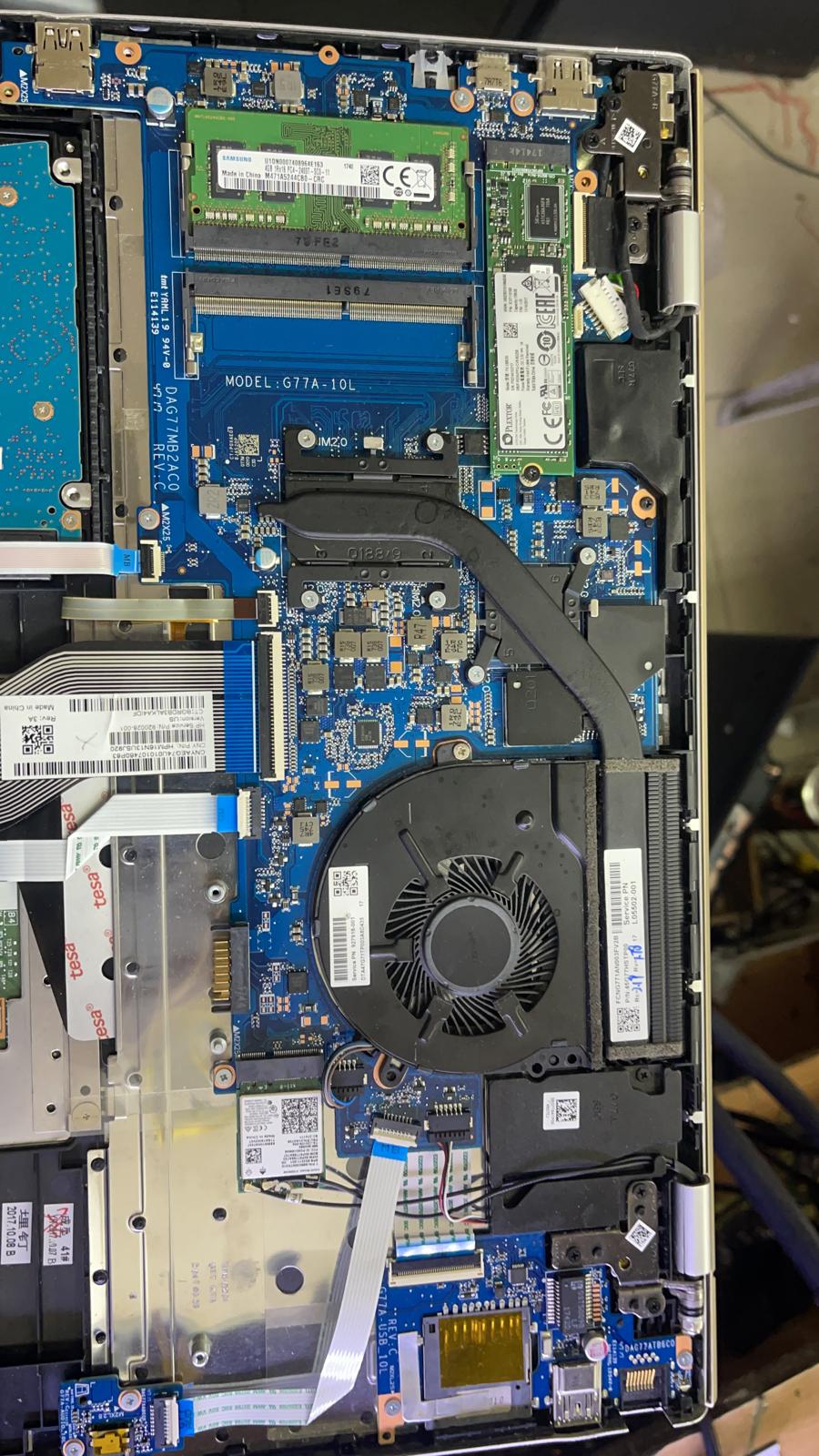

DAG77MB2AC0 REV C BIOS G77
SIR this one 64Mbits my mother board 128Mbits (MX25L12805D@SOP16, capacity: 128Mbits, 16Mbytes.)
it is possible
dear sir i program this bios but very slow coming display if i after off i need some bios my bios files 128Mbite but you are giving 64Mbite so how can support you don't have some bios i am sending my old bios you can check please dry to understand
how you know BIOS for 128Mbite or 64Mbite ?
dear sir i told you many time my old bios 128Mbite 16384kb 128mb i sent already picture of motherboard and old bios files i need very urgent 16.0mb i sent old bios already you can check again i am sending now
do you mean 16MB BIOS?
I check BIOS 16MB you send one have 8MB data 8MB is white
Because it was programmed by someone who replaced the 8MB chip with the wrong 16MB, Only experienced technicians realize this.
you need to replace the 8MB chip for programming
